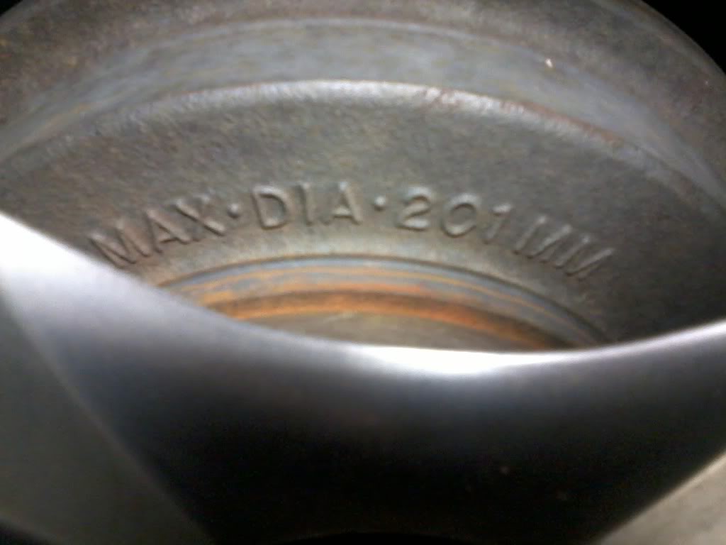

Originally Posted by johndeerebones
... don't know about the Jap cars for sure. Never paid attention to mine....
2001 model:
Old Sep 8, 2011
johndeerebones's Avatar
Joined: Apr 2010
Posts: 502
From: Missouri
Rep Power: 201
johndeerebones is a jewel in the roughjohndeerebones is a jewel in the roughjohndeerebones is a jewel in the rough
Re: What would cause brake shoes to go off center?
Originally Posted by lazlong
2001 model:
Thanks Lazlong!
As blatently obvious as that is I would hope that the turners of the drum saw that and heeded it. To the op, there it is! He solved that one!

what do you mean by turned the drums bigger than supposed to be? Mean they took too much off?
Thanks Lazlong!
I dont get the picture, sp MAX-DIA-201MM means the inner diameter of the drum should be exactly 201mm right? So you think they took too much off? what do you mean by heeded?
If the shop took too much of the drum off, then it wouldnt create a high point....wouldnt it be the opposite? they didnt take enough off? so maybe the diameter of the drum is less than 201mm causing the shoes to press too hard

That is exactly what I mean, turned bigger. The inside diameter can be more than the specs. It doesn't have to be turned to that diameter for information purposes though. If they aren't bad the turner may only need to take off a couple thousandths. If they are maybe they had to take off 20 thousandths for example which might put it over. They should take that into consideration, but who knows.
No, too much wouldn't make a high point, that is not my point.
Taking not enough off is not possible unless they don't take enough off to get any out of round out. Anywhere between stock and the max size is just fine. AND it doesn't matter at all if both sides aren't the same size as long as they are between the two. The effects of too big are that the pistons can actually be spit out of the wheel cyliders if they are grossly too big. Also the brake perpetual motion transfer won't work like it is supposed to if its too big. Also the shape of the drum can be a different arc than the shoes, causing the pads to not contact the drums fully. If the drum is bigger, the effect would be that the leading ends of the shoes would be the only thing that would contact the drum. This is also true of putting two rears on one side. Has the same effect.

That is exactly what I mean, turned bigger. The inside diameter can be more than the specs. It doesn't have to be turned to that diameter for information purposes though. If they aren't bad the turner may only need to take off a couple thousandths. If they are maybe they had to take off 20 thousandths for example which might put it over. They should take that into consideration, but who knows..
Sounds like i need to measure the inside diamete of them. Is it the length from the inside edge to inside edge of the drum?
Im going to take my drums to a brake shop and get them to check to see if my drums are still perfectly round. If its not then my shoes are obviously causing them to go out of round because i was told thats the only way drums should get out of round (other than being out of round out of the box).
