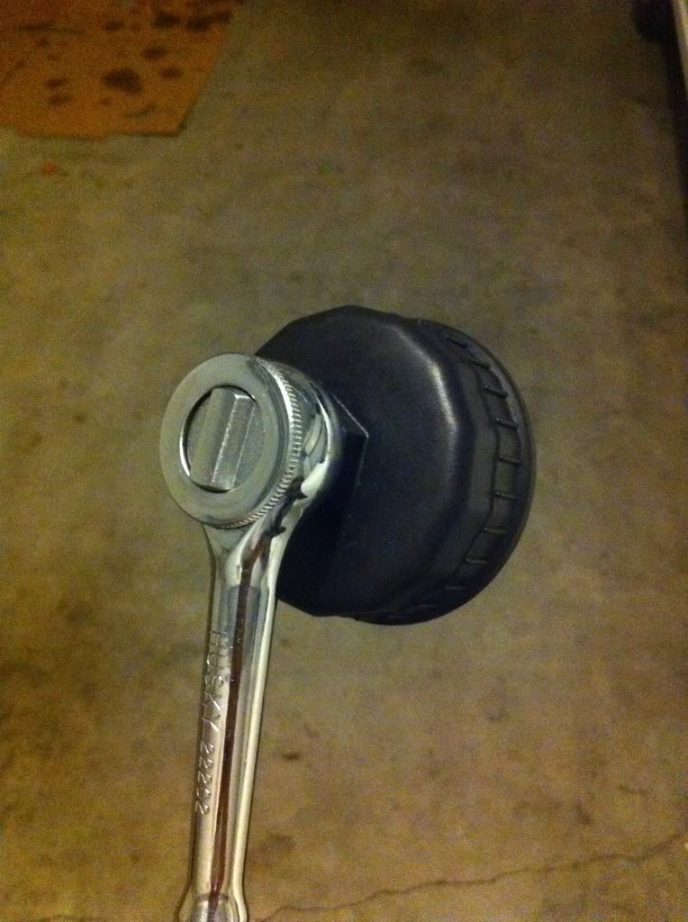

Btw, a filter socket works wonders for taking off the filter

I have had good luck using the metal caps that fit on the end of the oil filter and are turned with a ratchet. The key is to get the correct size, one that is a tight fit, not one that kind of fits but is a little loose. I take the new filter I am buying and use that to get the right size.

Re: Change OEM oil filter every second oil change?
I always learned to do it hand tight
Not like the incredible hulk, but a decent amount where its not loose.
As I said above, the filter wrench/socket thingy works wonders, dunno if the other filters have the hex type grip on them like the OEM, but if they do...
it's about $3 a wrench, and it fits on your 1/2" socket
EASY AS PIE when taking out the filter
