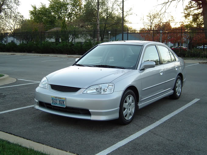

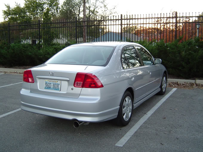

i have it on my 2002 sedan. very easy install with double sided tape and screws. on a scale of 1-10, i would say this is a 2 maybe. for the sides, you should stick the sill plates on with the double sided tape and leave them like that overnight. then install the sideskirt the next day. this gives the adhesive time to cure. ive had my kit for a very long time, and the only problems are with the sideskirts cracking a bit on the lower mounting points. not really noticable and there are so many attachment points it wont fall off. i can try and get some better pics but for now its all i have. its a very nice and clean looking kit.
actually i do have some really old pics when the car was almost new and stock. interestingly not much different than how the car looks now lol. i think i put the kit on in 2004. its one of the first mods i did and one of the only mods i havent changed or removed. this is at stock ride height also before i lowered it. the spoilers sit about 1/2 inch lower than the bumper.

Thank you! looks good. When you installed the front one did you have to take the bumper off. That is what I am worried about as I am not really wanting to do that on my own. May have a shop install the front one if bumper has to be taken off.
