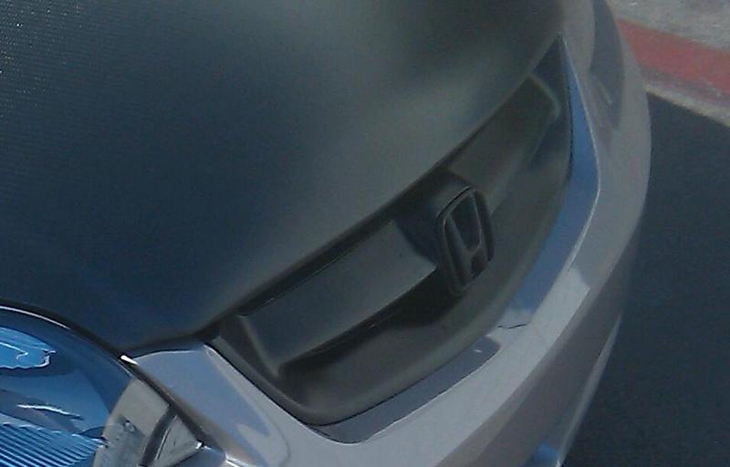

If you prefer a matte look, Plasti-Dip is the way to go. I painted my front emblem with paint and clear, countless times before, only to have a pebble or rock hit it... Lather. Rinse. Repeat.
Plasti-Dip is pretty much impervious to everything. It's not a smooth look, more like rubber. Google it. People Plasti-Dip grills, wheels, emblems, etc. Good stuff! I've never had to repaint my emblem for over 3 years now. And you don't have to be perfect with your painting technique either. Very Forgiving.

There are even a couple of guys who have painted their whole cars with Plasti-Dip.
Old Jul 25, 2011
Kennykid2002's Avatar
Kenny the Ricer
Joined: Oct 2009
Posts: 5,580
From: In your trunk
Re: How to paint something properly
I would imagine a vinyl wrap kind of texture and matte look
Not my cup of tea :3

ANYWAYS.
Now that I know how to do it properly, it's just a matter of deciding what's satisfactory while actually doing it.

I totally understand where you're coming from and I appreciate the time you take to explain the correct way to do it.. which is what I asked for (hence the title of the thread). Trust me, I'm not one to do a half assed job when it comes to my car. All I was saying is that it's a lot of work lol. I'm gonna do it the right way because of my experiences with cheap products and wasting my money (two shift ***** to be exact). In no way was I trying to patronize you, if that's how you feel. When I ask for help on civicforums.com I've always gotten high quality answers, and I'd expect no less.
ANYWAYS.
And I was not trying to give you a half *** way to do, nor was i trying to step on anyone's toes about how to paint something. I think you will do a great a job, you just need to go for it.

if you wanted to do the bleach thing like I said above you need to let it sit in the bleach for a litttle while and sand it down then start the priming.but i think it will come out good. everyones advice on this thread is really good and will work.just sum everything up and go for it if worse comes to worse its homestyle painting so i will come off with some paint thinner.

yeah for sure. if it doesn't come out right then I just try again

If you're using a gun and not rattle can, you can scuff the surface with a 3M scuff pad. It is the equivalent to a 320 grit sand paper but doesn't leave the sand marks. Then clean it and use a sealer. If the part isn't damaged, there is no need to prime other than adhesion purposes, in which case a sealer is more appropriate. A sealer is basically a diluted primer. You can turn a primer into a sealer by mixing it in a 4:1:3 ratio. Sealer is will fill in the scuffed surface. Once sealed, then time for your base coat. The rule for base coat is one coat past coverage. Meaning this, when you have achieved the color desired, do one more coat. For clear, 2-4 coats depending on how thick you spray it.
Using a scuff pad will quicken the whole process and make it easier. This is what we do at the body shop I work at.
