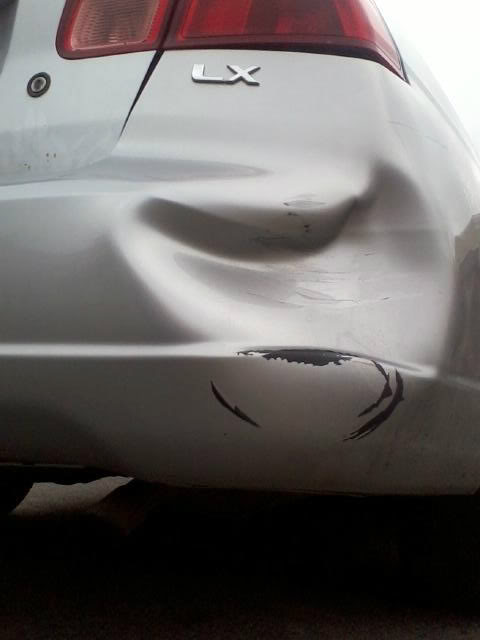

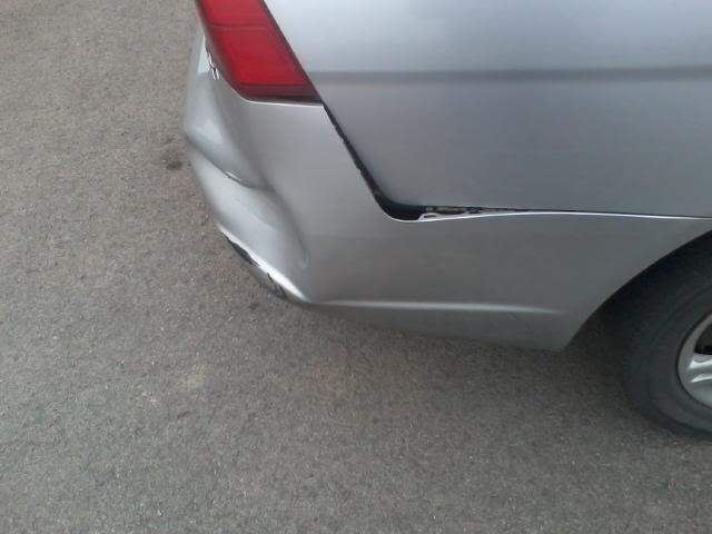

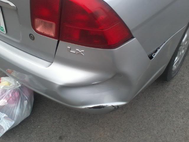

Not a day stopper. But, still. Not very good at all. Ya see. The neighbor boy(30yr old 350lbs by the name of 'BIGJESSE'[on the license plate]) had decided to park his 70 something mecury grand marquis half way in the street.
Now, it was partly my fault. Being the person I am, I stupidly believed others knew how to park. So, didn't really pay much attention while backing out. However, at idling speed. I would've hoped for a lot less damage. Of course, his car is made of metal, so there was not even a rub on it..
Still went to the park. Just had her laughing silently the whole time (I can't believe you crashed your car..he, he, he) So, now comes time to fix this. I went out a few minutes ago, and I can't bend it out by hand. Cannot afford shop work. Thinking about a hammer. Just wanted to get some suggestions first.
Any help is appreciated! Thanks, guys!

Ouch, that really blows
The damage looks too deep to just push out by hand at this point
But I would at least try to remove the rear bumper and somehow force it to pop back out
If that fails, at least you have the bumper off, just take the bumper to the shop, you pay a little less for labor
Personally, I would take off the bumper, clean out the inside of debris, then take it indoors (carpeted area), while wearing socks, try to step on the inside to pop it back out.

ehh evan if you manage to pop the dent out it will never really look the same i would just buy a new bumper cover either from ebay or certifit.com and have it painted it shouldn't cost more then 300-350 bucks certifit.com after market bumper cost around 80-100 dollars. having something like that on my car would literally drive me crazy.

check this out now i know you can swap bumpers from a 2004 coupe onto a 2002 so im assuming you can do the same on sedans but im not 100% positive your going to have to ask around but if you can then check this out

That sucks. You can head gun it and pop it out or go to the junk yard and get one. I would get a 04,05 bumper if you can find one tho.

Yeah, it's definitely too deep to just push out. Which is crazy considering I was barely moving fast enough to even be considered drifting...I like the take it off and step on it idea...How hard will it be to rip off the back bumper? I would love to be able to replace it. But, that amount of money is pretty hard to come by in our current situation. Hopefully, I can heat it up a little and pop it back, at least close to original. I know it's not going to be perfect. But, anything is better than this.

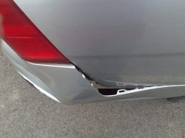

You see the tabs? Those hold the side of the bumper on. If they're broken (like the one on the right looks) then the side of the bumper will stay popped out.
I think you're extremely lucky it was just the bumper.

yep just use a heat gun and heat up the inside of the bumber and push it out best as poss.you prob wont get it back to normal like said above but if you can manage to get it out a lil more than it is and then take it to a shop then it may be cheeper but for now stick wit the sad face.

Yeah, I'm definitely gonna stick with the sad face, for now. No heat gun, but a blow dryer should do the job, right? That one tab is broken. But, luckily, that's the only broken one, so the rest should still snap into place.
I'm a little busy with work this week. So, hopefully this weekend, I'll have some time to pull the bumper off and take care of enormous eye-sore.
