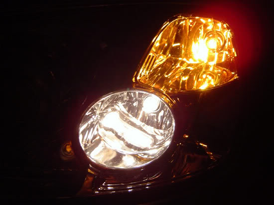

Re: Quick headlight wiring question?
here is how one side looks in park light mode. ofcourse you can choose to only have one or the other its up to you.

Old Jun 3, 2011
DarkSouljur's Avatar
Joined: Sep 2010
Posts: 807
From: Ottawa, Canada
Rep Power: 200
DarkSouljur has a spectacular aura aboutDarkSouljur has a spectacular aura about
oh alright well i'll just pickup some new bulbs tomorrow and replace the old ones when i do my retro
