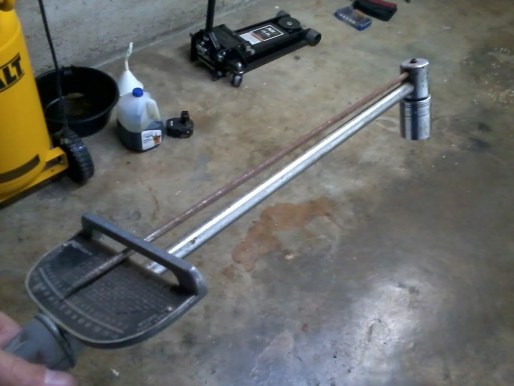

BTW: Anybody seen a beam-type torque wrench? My dad bought this one in 1972. Still works fine. lol

I have one of these that I bought not too long ago.. Actually it was a christmas gift... They work great and are just about as accurate as click type torque wrenches They also don't need calibration!!
