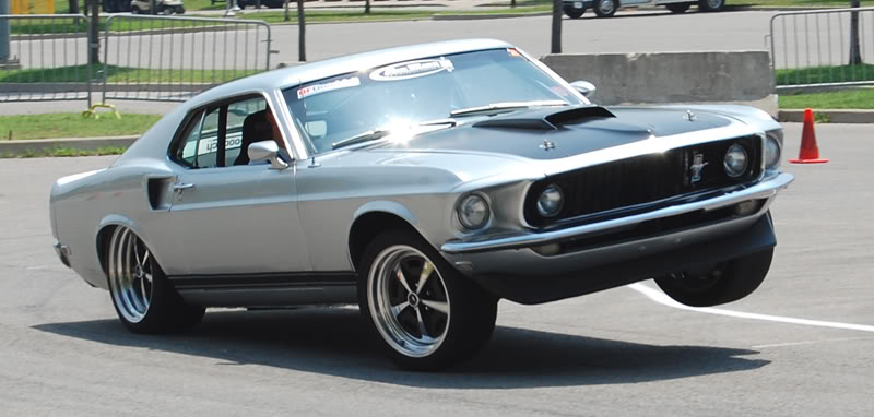

I think the missing key word would be: "whithin its working range".

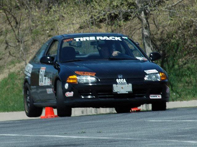

See a car that seems well setup (thanks, civicexracer, always nice to see another pissing dog action)
That shows a car with still 100% of the weight at the front distributed in both front tires - more front traction to turn, brake, steer (tires can only do so much...).
The rears? well, the left rear is doing everything by itself. Right side? It's taking its vacation in the air . Is that bad? well, not for a FWD, front engine...
Why? The rears do not do much at all anyways... (see above posts )
Don't believe?

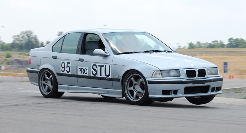

Well, rear drive cars does the opposite. this BMW usually keeps the front wheels off a feet or two...
and it's fast as hell...
This one shows more where the BMW is, but much slower...
A stiff suspension end will tend to lift its wheeel earlier than a soft suspension given same body roll. Naturally a stiffer suspension will have less body roll at same speed through a corner.
If considering same body roll, a stiffer sway bar will have less suspension dynamic droop, since the wheel in the outside will force the sway bar in its end to keep up, thus forcing the other end of the sway up as well.. That lifts the wheel up easisier given same body roll. Off course, the speed at that the body roll achieves same angle than a softer setup is much higher depending on the spring/sway rates.

Actually, a softer suspension keeps the wheels longer in contact with the ground.
I mean, if you weld a solid axle in the rear, it will be like stiffer springs or Sway.
Which is easier to lift one tire during body roll?
- the stock suspension which elongates and try to get back to ground?
- a solid axle welded to the chassis?
A: the welded one will lift much easier because it will follow the chassis. That means stiffer will lift the wheel easier - 100% weight transfer.
One less tire on the ground? Less grip (some of the load/grip non-linear tire behavious might apply, though...)
reading it back, I might have gone too far... sorry too complex...
