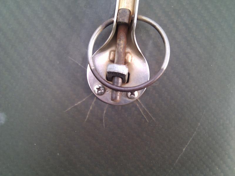

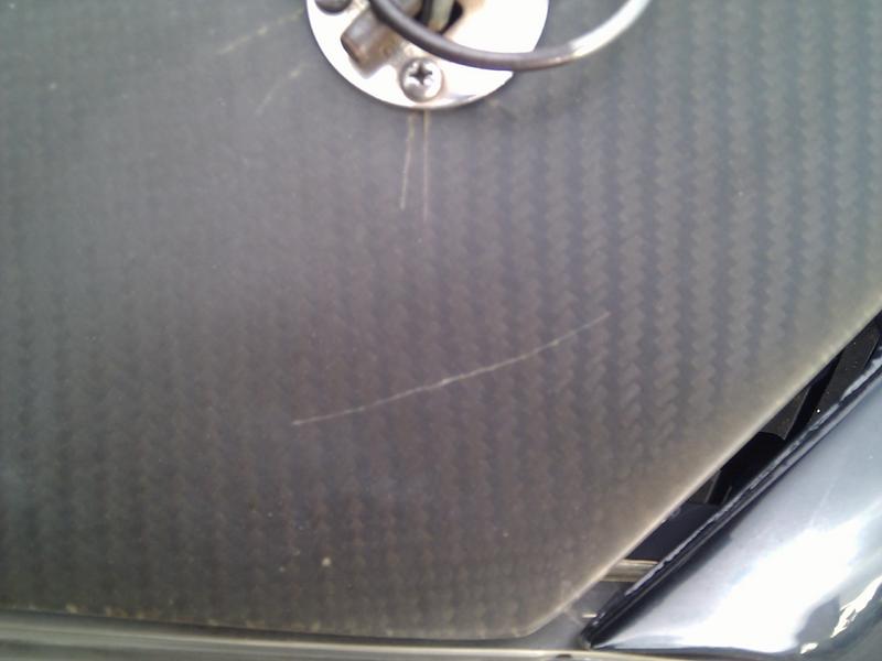

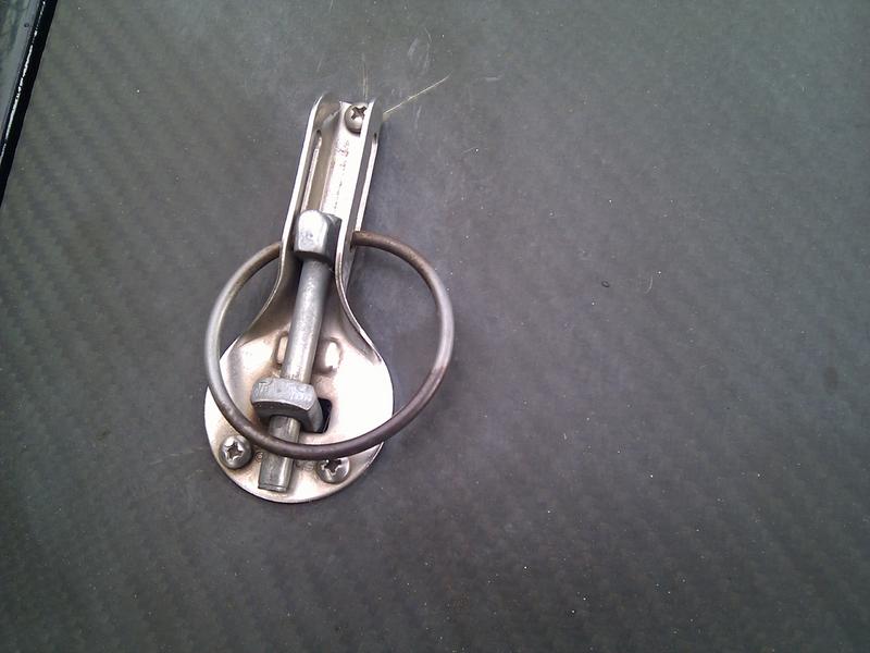

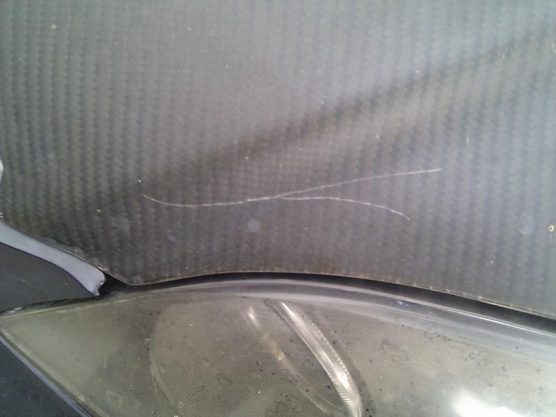

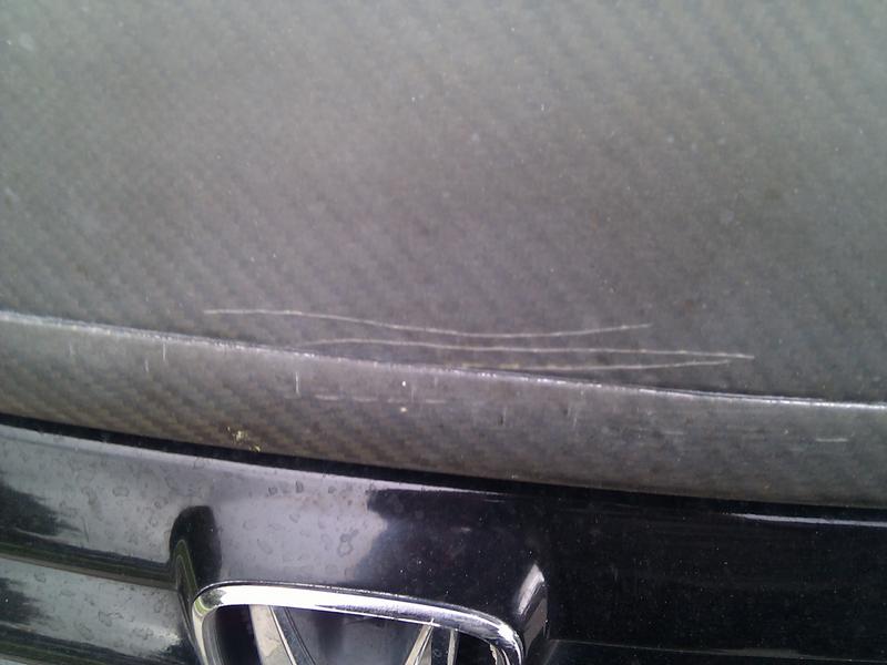

After I took these, well it sort of just convinced me that I need a new hood...

I know the cracks around the hood pins were always there.. the other cracks surprised me.. they might have been there but got bigger.. I'm not sure. I wouldn't rule out it cracking when other people were opening and closing my hood. (I had a friend try to open it not understanding what hood pins were. I could have sworn I saw him try to unlatch and pull the hood up before I went over and unlatched the hood pins).
Old Apr 7, 2011
Kennykid2002's Avatar
Kenny the Ricer
Joined: Oct 2009
Posts: 5,580
From: In your trunk
Re: To restore or not restore (the clear coat on my CF hood)
Yeah......those cracks look pretty deep, i'm guessing if you were to refinish it, you'd have to completely sand off almost all the clear, then reclearing it
I would not really advise you do this yourself, because you run the risk of sanding into the carbon fiber itself
