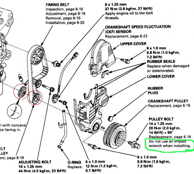

^ Yes the teeth are on the crank. If the pulley was held on by friction from the nut then it would tighten but it's not it's just there to make sure it doesn't slide off the teeth. The key is there to make sure the ignition marks align properly. The impact gun breaks the torque fast enough that it won't rotate the engine, which wouldn't matter anyway because your timing belt and pulley would still be attached and held in alignment by the teeth of the T.B. pulley. Every time I've removed a pulley it has taken the same amount of effort as did installing it.
Check out how the manual only says not to install the bolt with impact wrench. Nothing about removing it...
I am basically done discussing this. I have never had any problems with using an impact wrench, I find that it makes it extremely easy, even when I have had access to the special tool.
I was simply trying to tell everyone that they don't need special tools for every job. If you follow the factory service manual then you will spend a lot of money on special tools and you will waste your time.

In other words you still need to tool to properly reinstall the bolt? Timing belt is installed before the crank pulley (just info for those that havent done it before) and rides a seperate pulley called the Timing Belt Pulley or something like that.

The engine has enough compression to stop it from turning upon installation.

i wouldnt count on the compression to stop the crank from turning....also when you are tightening the bolt you are basically trying to rotate the crank in the opposite direction of its normal travel which is never a good idea....

I was able to torque the crank bolt down just using the engine compression...It didn't rotate for me
