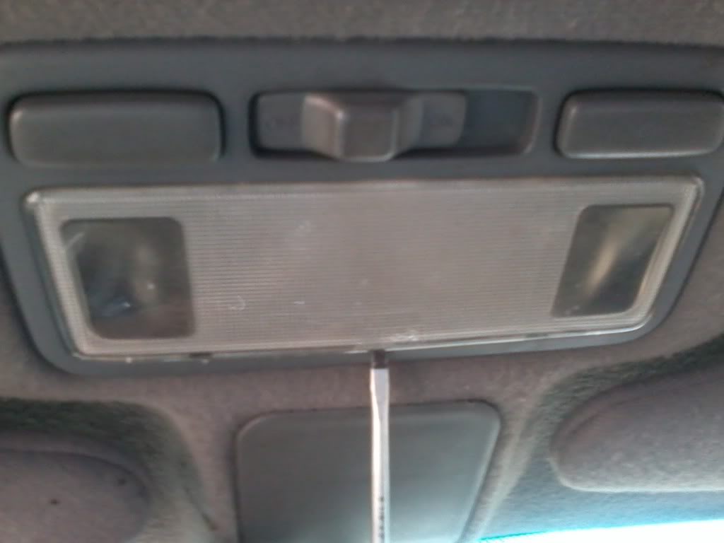

There are 3 places on the edge of the cover (towards the front of the car) where you can stick a small flathead into and pry out. My flathead is in one and you can see the other 2 on either side of it.

Sorry about the fuzz, phone cam.
