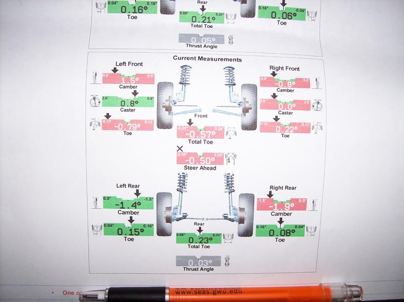

The car has 112.000 Miles ... I measured the sides today on the rear drive side from the ground to the fender its 25.25Inches and on the passenger side its 25.75 Inches . I have attached the alignment test results here, I was wrong about the Camber measurement its actually -1.9 and not +1.5 (I'm putting a Camber kit in the front ) I just changed the front Mounts and the spring hats with this stupid plastic bearings

Old Jan 9, 2011
Posts: 15,180
Likes: 1,606
Re: Rear Camber kit for stock setup-Why?
you have too much positive camber in the left front as well.
Your right rear camber is too negative, but you say you left is lower?
Or you need new bushings, or you have bent suspension (not only rear, but fronts as well), or your springs are tired (112k should not be enough for that, but...).
Did they not find any bent parts?
If not, you should try another shop...

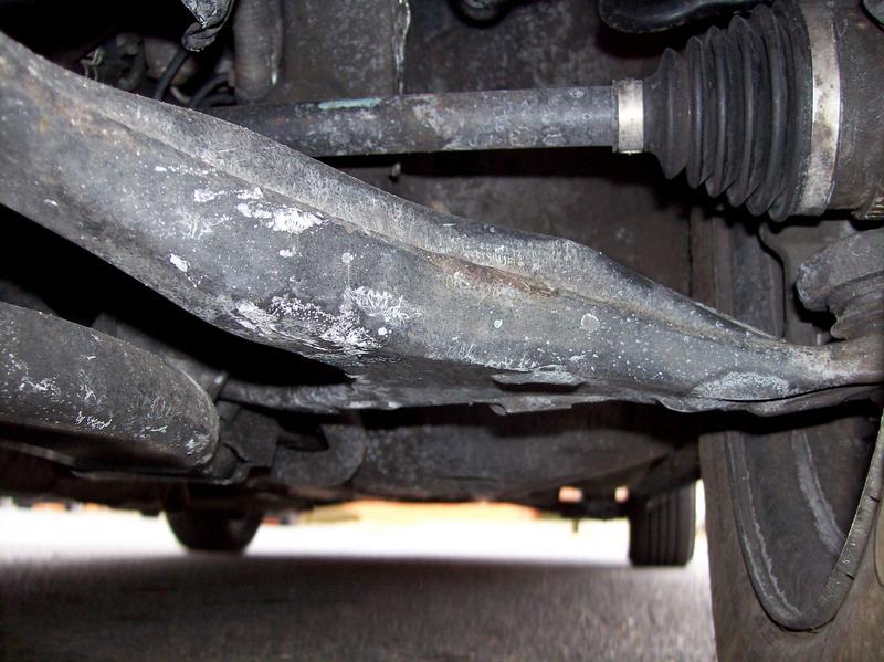

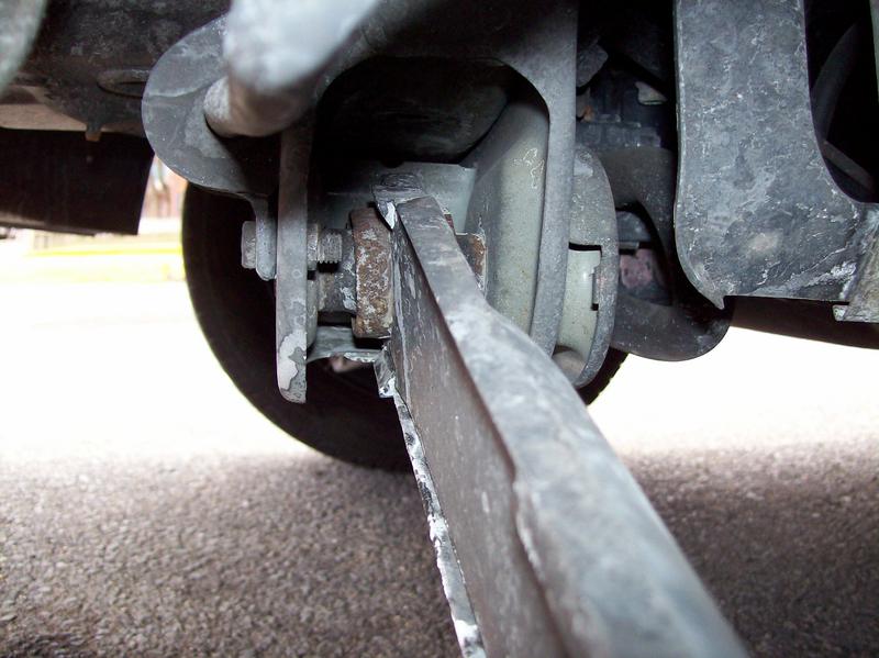

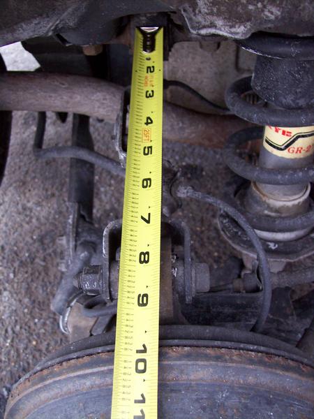

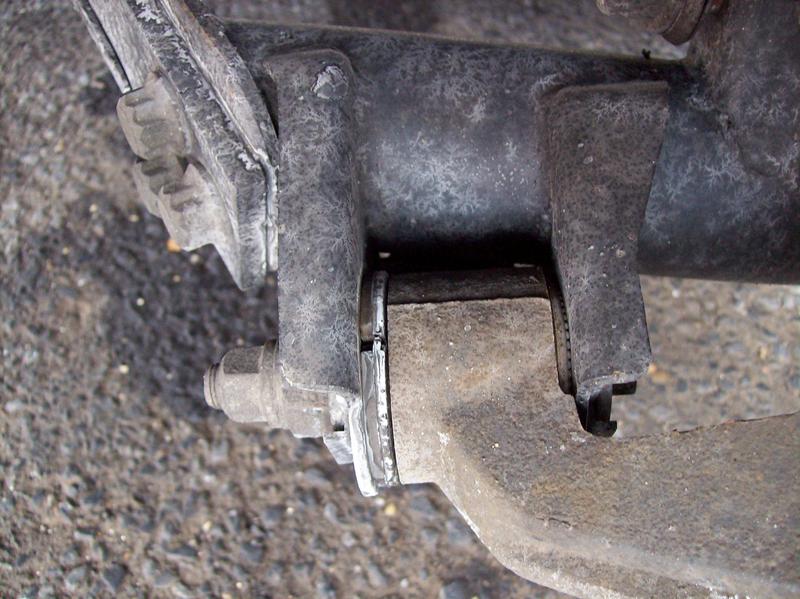

I opened the rear suspension today and toke pictures I hope this help
I will post the right side first and the left side next
Picture on the left is Right side (passenger) picture on the right is driver's side

Old Jan 10, 2011
Kennykid2002's Avatar
Kenny the Ricer
Joined: Oct 2009
Posts: 5,580
From: In your trunk
Umm, those pictures dont really help....
It'd be better if you post a picture of the tape measuring the gap between the fender and tires

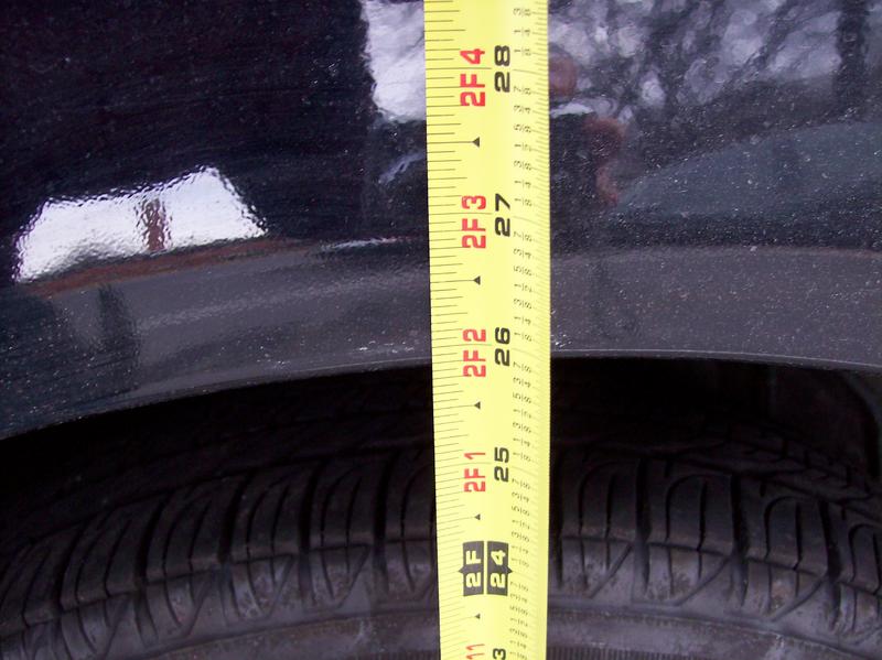

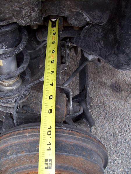

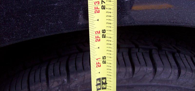

I could see there is 1/4 inch between left and right rear camber from the previews pictures (Look at the zero of number 10 as well)

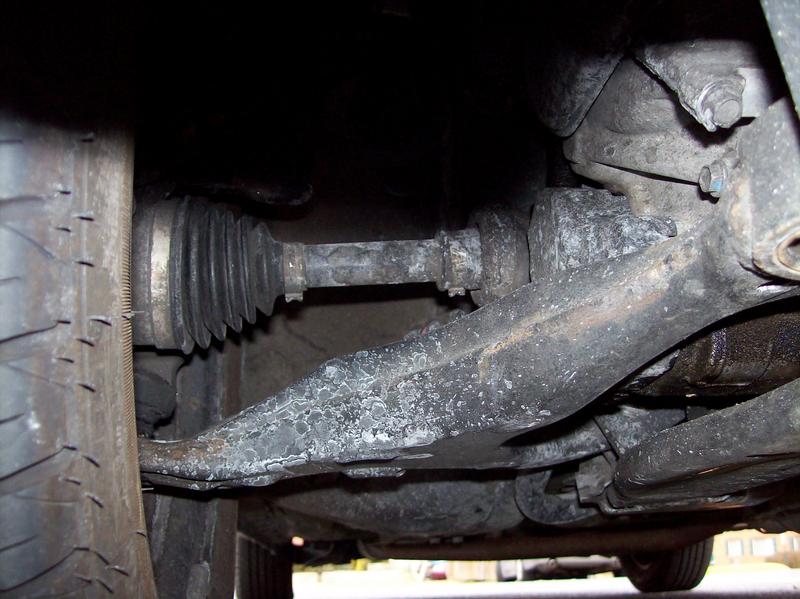

Here is the new fender to ground tape measurements. I aslo added picture of the front lca's But Im not sure if it helps.
Driver's side
Passenger's side
LCA's
Driver's side
Passenger's side
I dont have any subs !

Old Jan 10, 2011
Posts: 15,180
Likes: 1,606
firestone shops are hard to tell - if you get lucky, maybe you can get some good technician.
for bent LCA, one way is to measure them in length, but not much helpful.
the best is to ask around to try to find a good shop around your area. A 1/2 degree might be very small difference.
Also, your bushings might be torn or cracked, or similar, visual inspection. If they are too bad, they could be allowing too much play and changing alignment under loads.
Could also be play on the front crash bolts or the rear toe bolts.
just try to find some good shop and have them inspect the car.

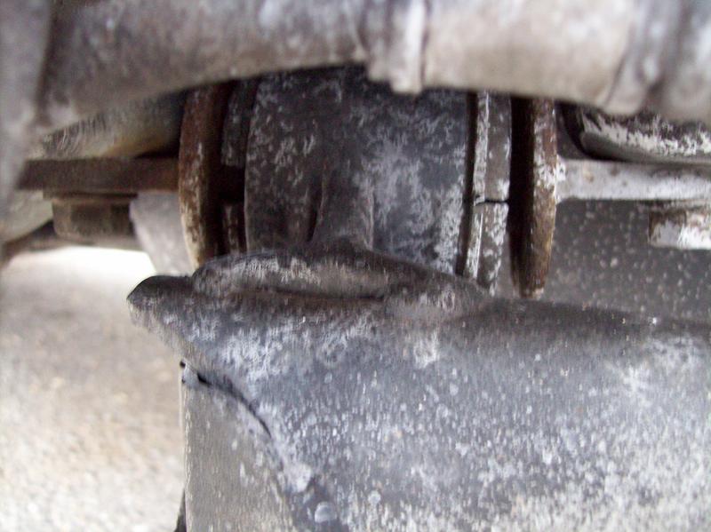

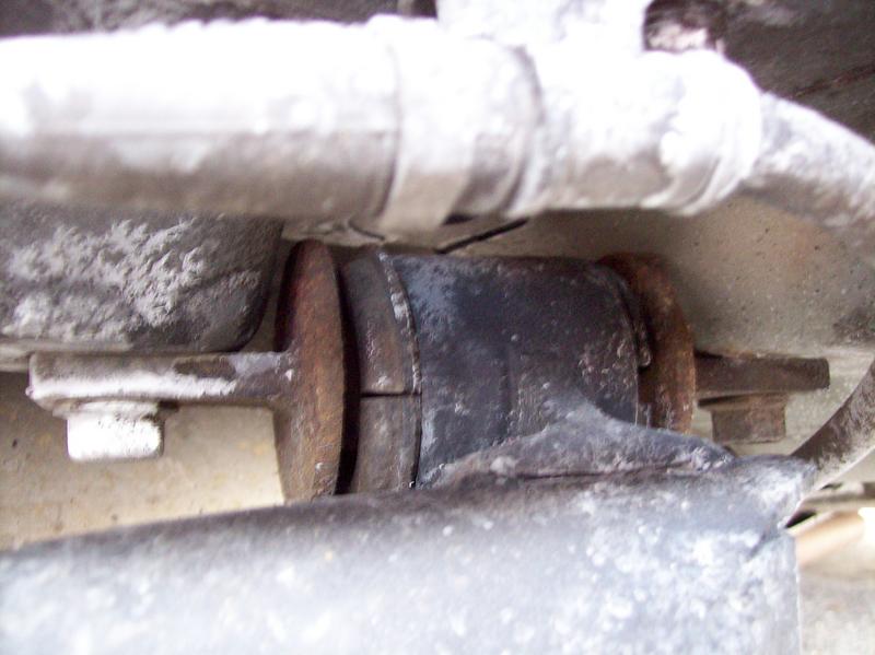

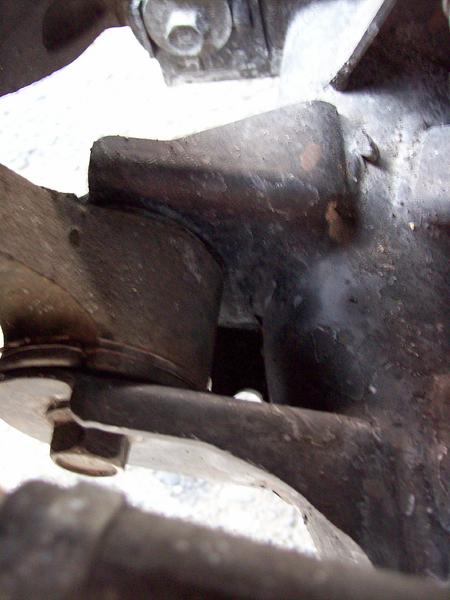

I toke allot of pictures from the rear suspension bushings. I also bought and SPC rear Camber kit for $50
Here are some bushings pictures

Old Jan 11, 2011
bravo79's Avatar
Joined: Oct 2010
Posts: 206
From: Maryland
bravo79 is an unknown quantity at this point
I hooked up the rear camber kit and the front camber kit today and toke the car to Firestone to get an alignment... It toke them 2 hours than they call me inside to look at it
After putting the camber kit in the rear the passenger rear toe is off and cannot be adjusted because its maxed out !!!!!!!!!!!!!!!!!?????????? How can a camber kit change toe ?
The left front wheel still have + camber and cannot be adjusted more. It was at 1.5 not with the camber kit its 2.3 ????????
I dont know what think at this point .... If anybody know something about this issue please share your info
