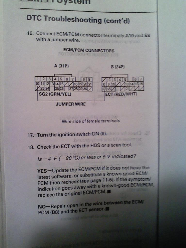

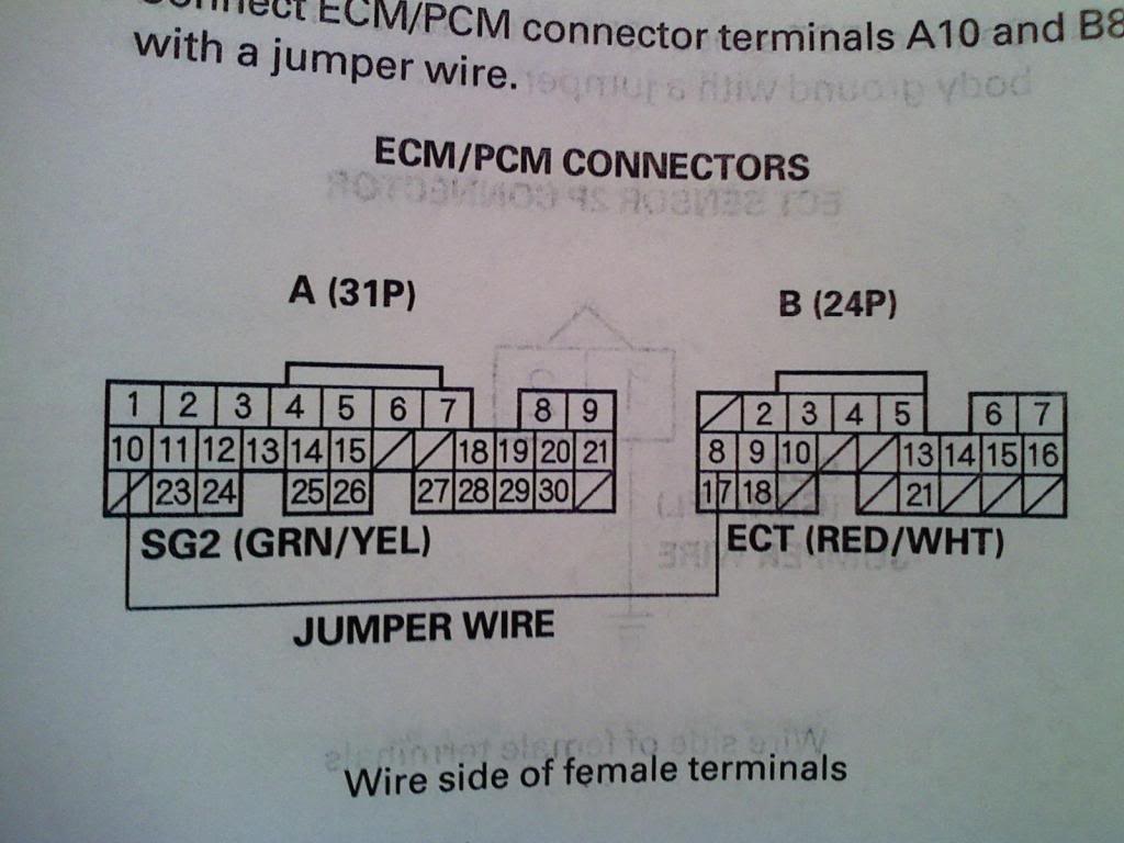

1. bad cluster
2. bad ECM/PCM
3. short in the wire between the IAT and ECM/PCM connector A10
4. short in the wire between the ECT sensor and ECM/PCM connector B8
Looking at the service manual for P0118, I'm betting on an abraided/broken wire or bad connection somewhere as this would make the cluster read wonky too.
All the ECM/PCM connectors are different sizes so there is no way to get confused. Just count the number of pins and there should be no problem. Here's a pic of the pins and wire colors you're looking for:
Service manual says you need a scan tool to properly diagnose. If you have access to a scan tool tell me and I'll post the diagnosis tree. Otherwise I can't narrow it down anymore.

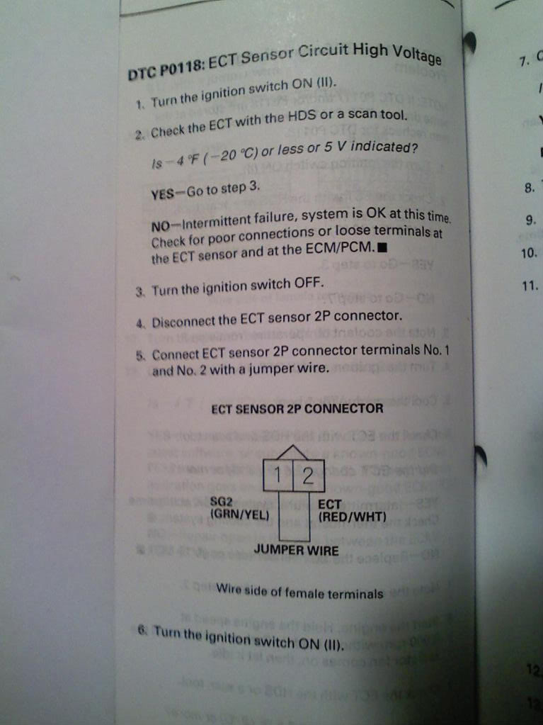

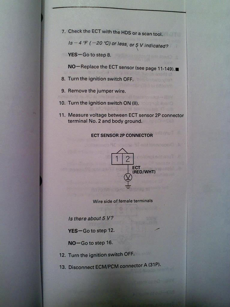

Connectors are plugged in to the ECM/PCM which is under the passenger dash behind the glovebox. IAT is plugged into the driver's side of the air cleaner box. ECT is the one you changed. Coolant fan switch is the "bottom" one plugged into the thermostat housing.
If your scan tool is two-way then you can probably read live data feed too so, here:

Sorry about the fuzzy pics, phone cam. Good luck, keep us posted. Pics are nice too. lol
