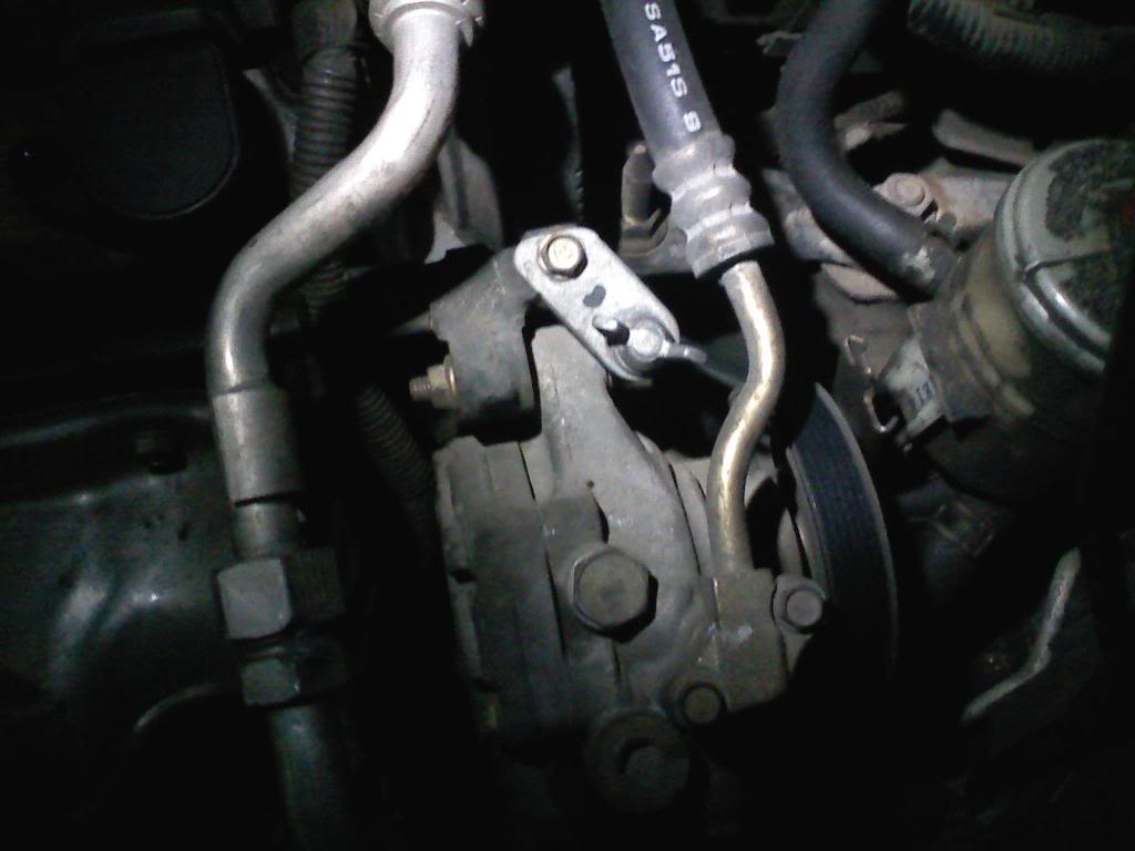

I have a 2002 ex civic.
everything is stock completely haha
I dont even know if this is from my car, but I am 90% certain it is.

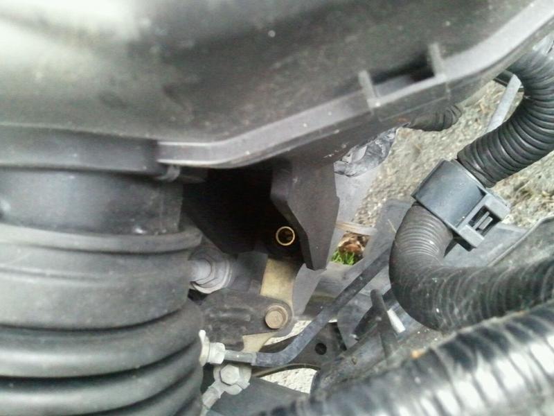

This is the screw (first picture) and I think it goes here(second picture).
but i dont know for sure... what is that second picture anyways?

that looks like the wingnut for the alternator! doesnt belong anywhere in the second pic area. it looks like you are missing an air intake bolt tho. lemme try and snap a pic, i remember seeing that bolt a few days ago. its not the one at the top of the bay where the power steering is, its down below in the front where alt is. i had mine almost fall off once too and the belt started squealing. i prolly have a spare bolt for the air intake if you want. just pay shipping and packaging $2.

Sits on the PS pump like this:

top one on the PS pump should be easy to see if there is a hole in that spot. otherwise its the bottom one. here you can see it peeking out under the alt. i really have no idea how you are able to drive with that missing.

Once the wingnut is adjusted and the other bolts are holding the alternator in place that wingnut can fall out with the alternator not moving. Not really a good thing by any means though. Get that back in A.S.A.P.

Its not from the PS! Wow I can't even put it in the alternator. My hand doesn't fit. And how will I know when its tightened enough? How much would I get charged by a mechanic? Help

well i had to go under and remove a black cover, but i got it in. there was also something else loose so i tightened both up and now there is no noise yess..
