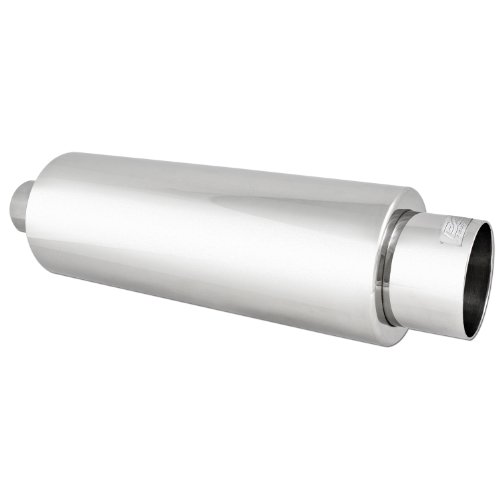

This is the muffler. It's stainless steal 2.5'' tip

dc sound clip
http://www.youtube.com/watch?v=R9g_fu_Yii8
i would get something like this if you want a deep tone
http://daddyscaraccessories.rpmware....6/i-37097.aspx

my canister on my catback is like 4.5 inches. and its not an oval, and its not raspy at all. check my sig. im pretty sure raspniness has nothing to do with if the canister is oval or not. i would go with a full catback if you want a deeper tone.

the longer the canister is the deeper the sound will be, the shorter it is the more high pitch raspy, and majin does your exhaust system have a positive resonator inline with the catback system, and the 4.5 i assume means diameter of the muffler. All those canisters are is just a shiny cased glasspack. 15-18 inch long canister will get you a really deep tone with a 4 cylinder, 6 inch glasspack (canister) will sound like a never ending fart tube. 12-15 inch long muffler will have that i'm a sporty civic sound. this is just rough estimates. I ran a 18 inch glasspack on an accord and it had a very deep tone.
