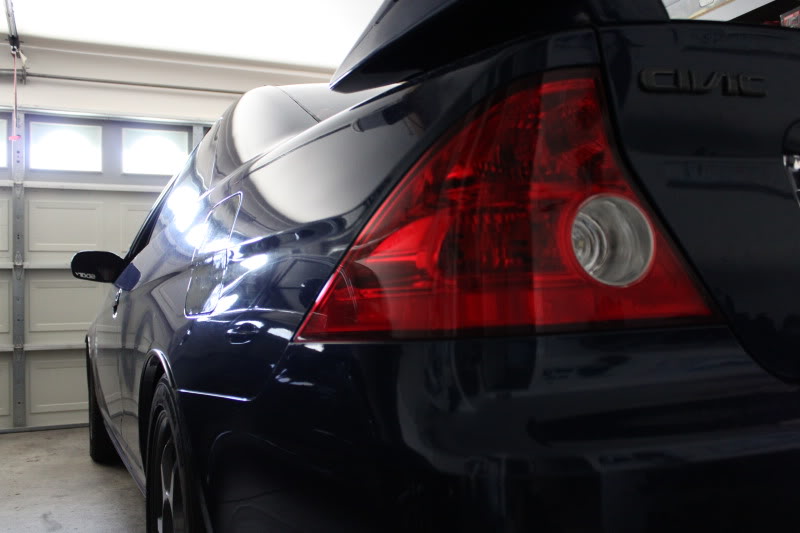

I dunno about spraying them red.. I guess it'd really have to depend on how well it flowed with the rest of your car.
As for the metalcast, I was able to find a can of it easily at an o'reilly auto parts. Sprayed my Honda emblem, civic emblem, and ex emblem with 8-10 coats of the stuff.
edit: I thought I had more/better pics of them, but you can see my Civic emblem

Wow even with ur car being a darker colour it still looks really nice. But how did you spray the civic emblem? Did you take it off and spray it?
Just wondering because if you took it off wouldn't you have had to remove the adhesive? If so then how did you get it back on?

I have a few rolls of 3m double sided tape laying around for random automotive use.
here's how I did it:
-Marked 2 adjacent edges using delicate surfaces masking tape
-Pulled the emblems using fishing line
-removed the adhesive from both the car and the emblems by hand
-sprayed the emblems, one coat at a time, allowing at least 15 minutes between coats (8-10 coats per emblem)
-cut some of the tape and applied it to the backs of the emblems
-cleaned the surfaces on the car with soap and water
-reapplied emblems
My car has a dark motif goin on, gunmetal rims, carbon fiber hood, blue/black carbon kevlar gas door, color matched headlight bezels sprayed emblems. The way I sprayed the emblems gives them a gunmetal look, and almost match my rims perfectly. My color scheme continues under the hood, with a dark blue candy coated valve cover, gunmetal colored wire cover and fuse box cover, gunmetal colored intake pipe.

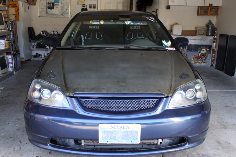

Fiberglass patch behind it with bondo to smooth it out on the front. Should work perfectly.
I'm really bad (rather, good) at threadjacking.. hahaha..
But yes, debadge the front with an altezza/type-r grill. I think you'd have to get the sedan radiator cover (part number 71122-S5A-003) to make it work, but whoo-de-doo, another 11 bucks (plus shipping) online at south bay honda (majestic doesn't ship to canada), or $20 at the stealership.
and WHAMMY! de-badging action!
many people just paint the lip and leave the center portion unpainted (black). Some people leave it unpainted altogether for the black/[insert color] look. I personally think the unpainted center (the mesh area) with the painted lip looks the best. Gives it the contrasting color look without it being all "BAM!" in the face-status.
and yes, I know my hood looks like doggie doo-doo.
