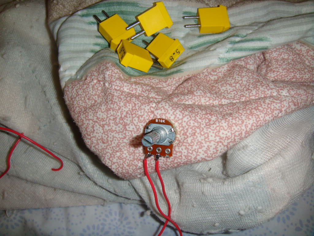

I bought an Autometer 5340 Pro Shift Light. Instead of using the($25 a set) rpm pills; i decided to use a 10k ohm potentiometer and a simple molex connector from radioshack for about $3.00:up: If you cut one open; you will see that each rpm pill contains a cheap resistor:down:. They are not worth the $25! The potentiometer will serve as a variable resistor, it also comes with a **** for adjustment.

potentiometer w/wires attached

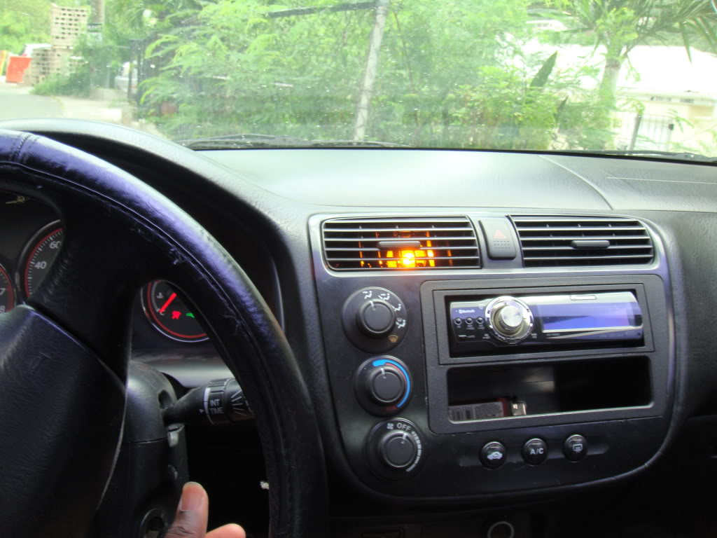

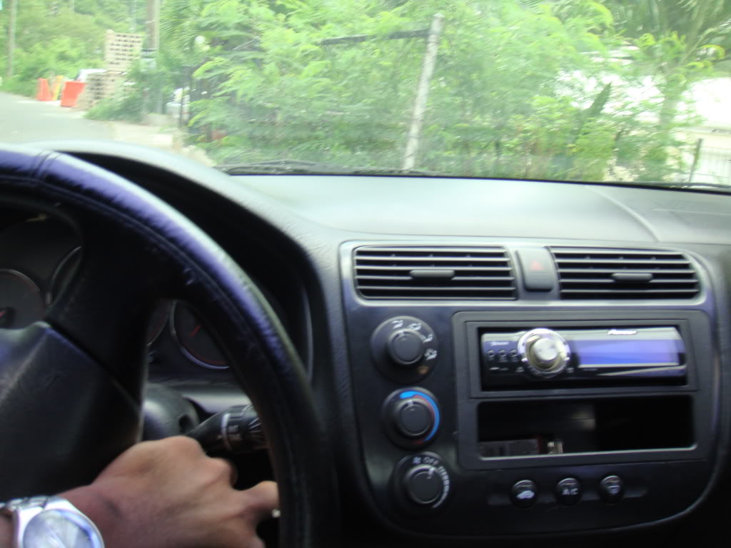

end result!:up: trust me its bright! and easily adjustable!
OFF!
ON!
This shift light is easy to adjust. Its also very bright and visible in the day and nighttime. I set it to 3000rpm for daily driving and fuel economy and then back to about 8600 rpm for racing. You can turn the a/c vent in another direction if its to bright or simply turn it to an unreachable setting like 11k rpm if you want it off. Its well worth it:up: Accurate and consistant shifting pays dividends:
