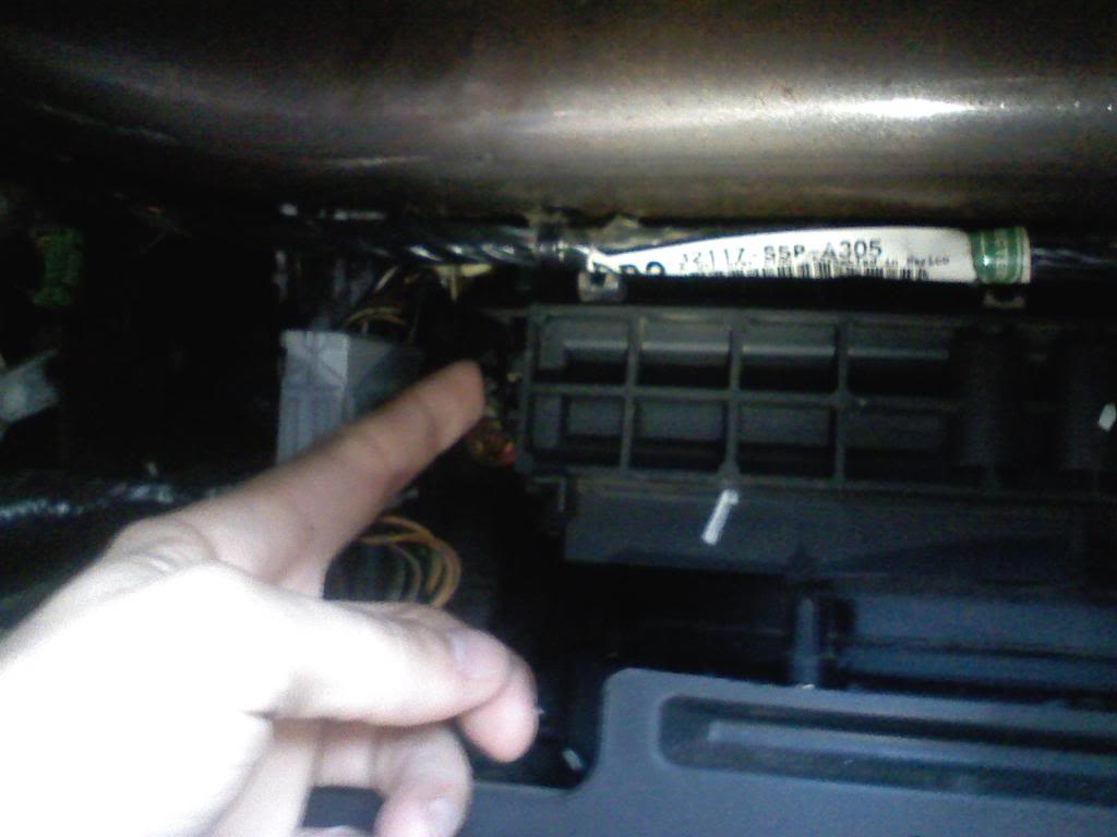

pardon me but can someone tell me where is this cabin filter located in 05 civic?
My AC is pretty much OK but i have no idea about this cabin filter thing.

I know on the 04 civic the cabin filter is located behind the glove box. You remove your glove box (quite easy) and there should be plastic slider cover. You slide them and just pull them out. It's quite easy.
My finger is on the cover lever:
