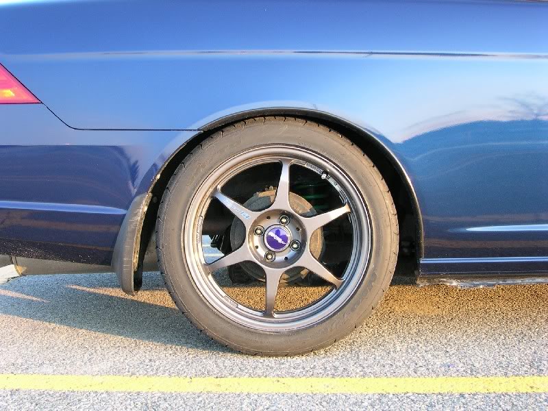

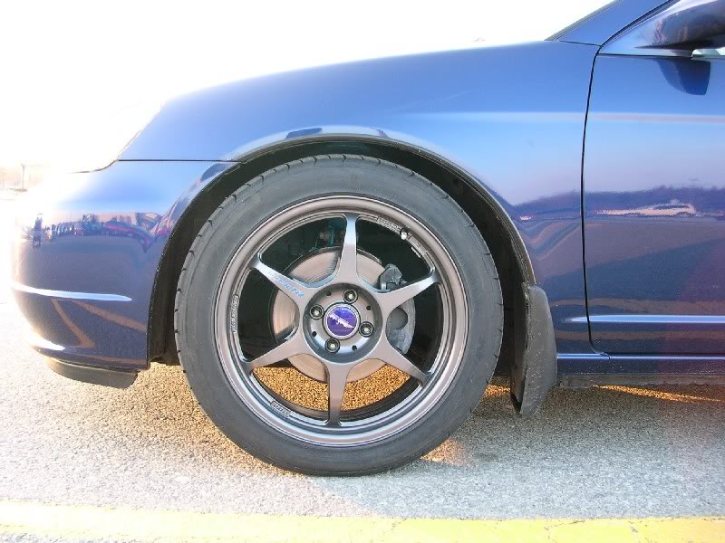

that's dropped on tein s-techs with tokico blue shocks.
front closeup
rear closeup
even with the closeup, you can barely see the springs. That said, I doubt color would matter that much, unless it'll bug you deep down.
