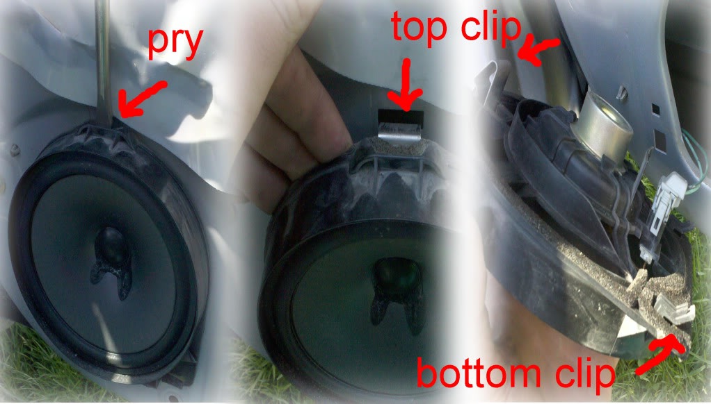

Next, remove the stock speaker from the door. All you have to do is stick a flat head screwdriver into the clip at the top, press down and push out. Then lift it up and away from the door and disconnect the wiring harness. Easy.

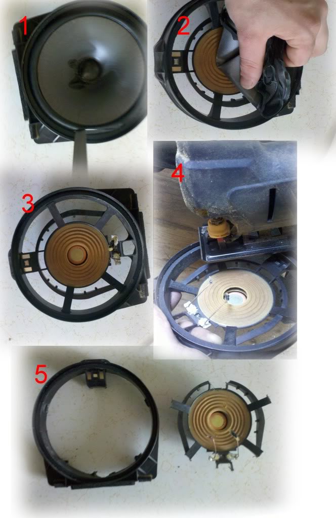

The first thing I did was rip off the old speaker cone. Then I took a jigsaw to the plastic supports that held the old magnet on there. The only part I didnt cut of was the clip that held the unit on at the top.

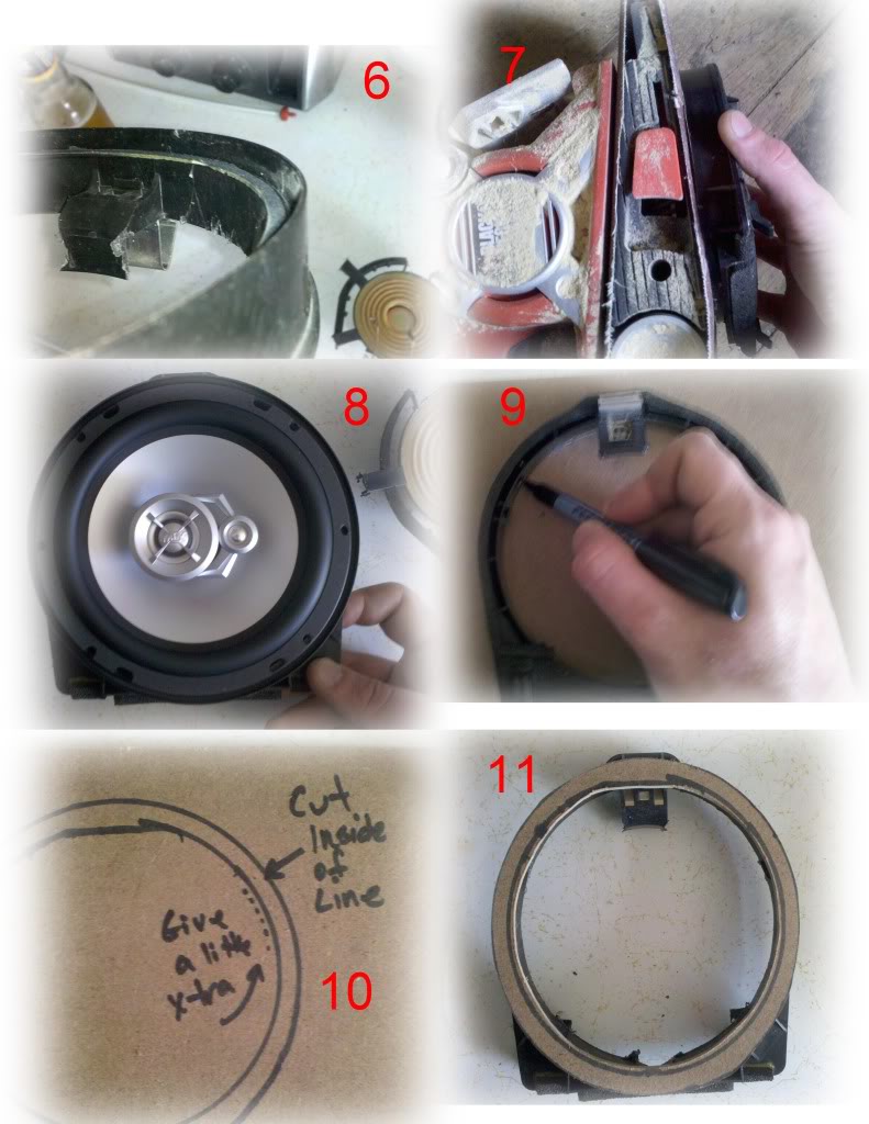

Next, I had to flatten down the lifted rim around the outside. I cut it down with the jigsaw, then smoothed it with a belt sander. Then I checked to make sure the new speaker would sit in the new mount nicely ( it did, as I knew it would). Next I traced the outside and inside of the mount onto a piece of 1/4 inch mdf, and finished whatever lines i couldn't trace by hand. Then I cut out the ring, leaving a little extra wood on the inside of the ring, for a little more strength. Once done, I checked to see that it fit nicely onto the mount.

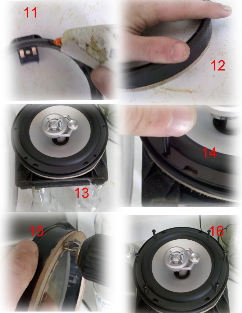

Next, I hot glued (yea that's right, hot glue ****'s lol) the wooden ring onto the face of the mount. I used hot glue because it would eliminate any rattling, seal up any bumps that werent sanded down nicely, and set quickly. The actual speaker will be screwed in through the wood into the plastic, so the glue doesn't need to hold anything together permanantly. I pressed the unit down onto the wood once glued to squeeze out any extra. I set the mount on beer bottles to hold it off the ground, then dropped in the speaker and marked dots where I would drill pilot holes for the screws. I drilled the pilots, started all the screws, then finished screwing them in once they were all in place. This unit is now very solid, and is ready to be simply popped back in where the old speaker went.
