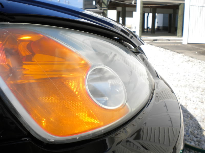

well here we go:
before:
After:
finally. thank god.

i didn't buff hard enough
i'll have to redo the buffing when i do my girlfriends car tomorrow
still alot better! and no moisture

Re: removing calk
Huge Improvement!!!

Re: removing calk
looks great, a bit more work and they will be like new again
