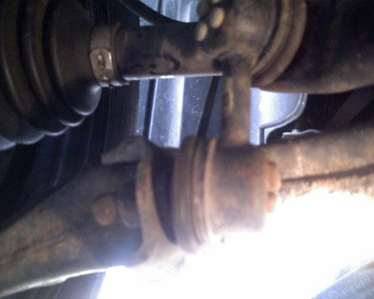

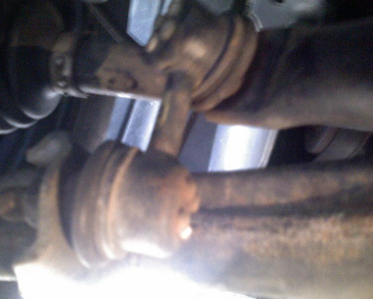

What do you guys think about this link? need to replace?
Or does it look normal?
I've been hearing clicking sound when go over very small bumps. I've read that it could be the link...
This link is on the driver's side.

its hard to see in the pics, but that connecting bar should be straight. if it is bent like i think it is, time to replace before it snaps. also since the oems are not greasable, they will wear out over time and start to make noise due to lack of internal lubrication. the moog replacement links are pricey but much stronger. kragen and advance auto should carry em.

Yeah, the bolt connect to the link is bent. Not sure if that would case any click noise however... There is a click noise when go over bump that has been driving me crazy.
