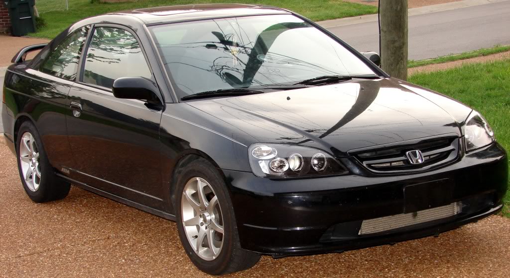

the car came with blacked out lights, so not sure how long to disassemble them - there are write-ups in the forum.

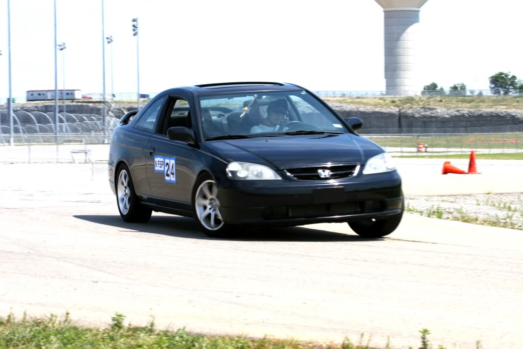

They got very bad and i replaced them by projectors now. they look ok compared to the beaten up ones i had, but many say they are weaker than stock new.
Ricey, yes... Did not connect the halo, not sure if i ever will, wanted to see if projectors were better to illuminate... They don't leak for more than a year, so luckier than others. just installed the amber bulbs, so now legal in Canada, not sure if they will stop me for using non-stock lights though... They were legal in US before i moevd here...

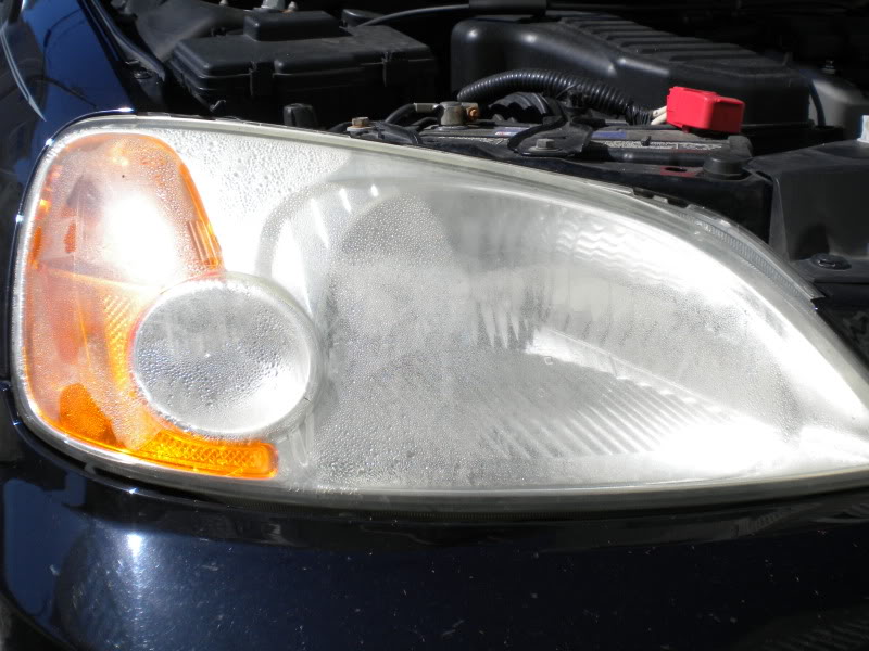

Hey Guys theres a few things I want to fix on my car before I do mods, so i was looking for a little help/guidance
-First, Moisture in the Headlight or Haze?
I saw a thread on the DIY section, and a guy fixed his hazed headlight with sandpaper and buffing, here is my head light:
is it hazed or is moisture that is fogging up the inside of the headlight, which would cause me to take off the bumper and take apart the headlight

thats moisture in there take it off let it all evaporate then reseal the edges with sealent. the trunk should buff our if you know what you are doing with rubbing compound but you could get better results if you take it to a professional detailer.

that is moisture, more likely... haze is completely different... especially when i can see it from a picture...
go to the DIY or look for headlight/black casings or something like that and find how to disassemble it, paint the frame black like mine were, seal it with silicon and put it back.
