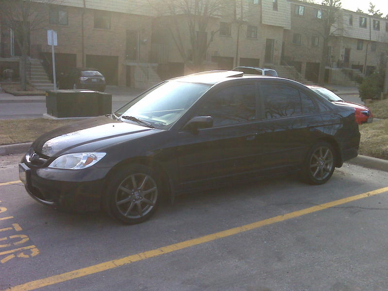

sloppy work in MS Paint but gives you an idea... i think it would be worth it to save some money and get aftermarket gunmetal wheels but just my 2 cents...

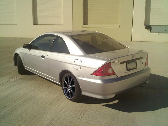

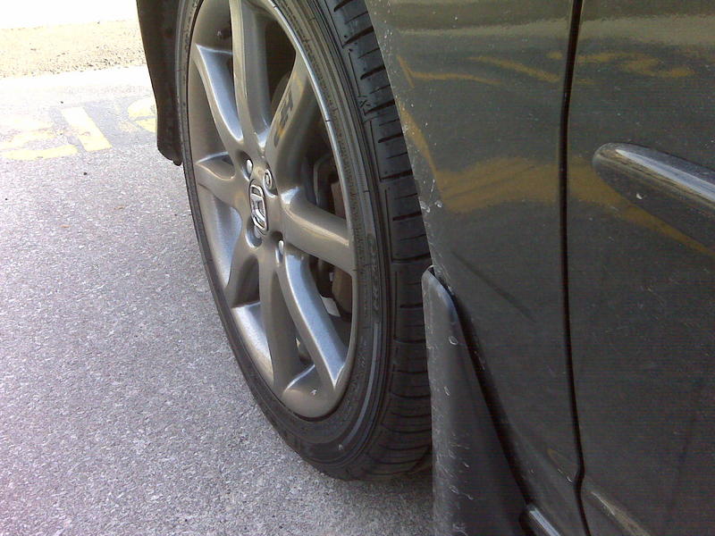

Haha, A member posted these pics about a year ago and the thread was just bumped last week. I saved the pics to my computer cause I was thinking the same thing, he said no fitment or rubbing issues at all. Thread was called Honda fit hfp wheels if you want to find it.
