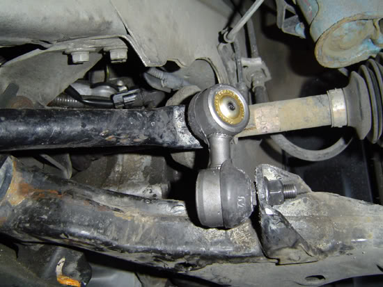

yeah sway bar link prolly snapped. next time get MOOG endlinks they are twice as thick as stock (unfortunately costs almost $100 for a pair). without the front sway bar, the steering feels very loose and you have to turn the wheel more to make the car go in that direction.
