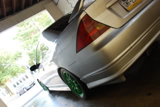

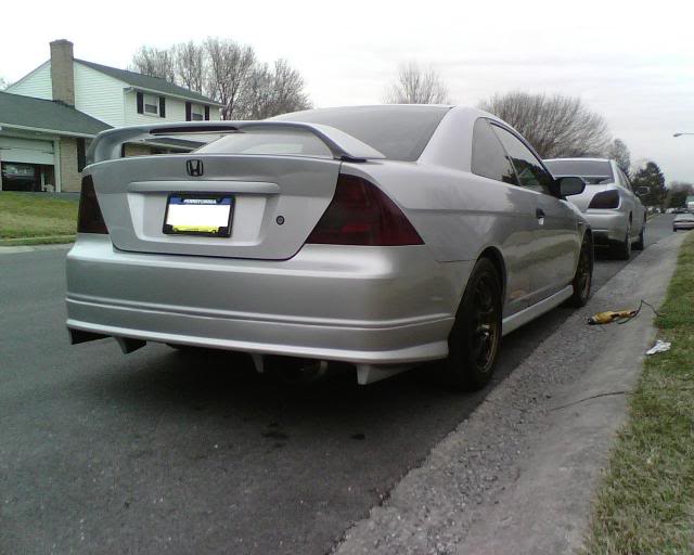

acetones my best friend it would never hurt me lol just kidding but yeah i knew what it could do so i went lightly with it..see not too bad
before
after
