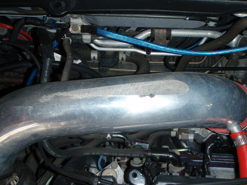

before i installed my aem intake, i took a couple pictures of this intake just before i removed it incase anyone ever had this problem. you can see how i barely have any coupler, just enough to connect the pipe. you can also see what happens to the top of the aluminum intake when it continuously rubs against the hood (this happened for a while until i cut more off, then it stopped). it just slowly grinds away. if you want to keep yours looking nice, cut as much off the bottom of intake, and bottom of the coupler as you can. the top doesnt really matter.
