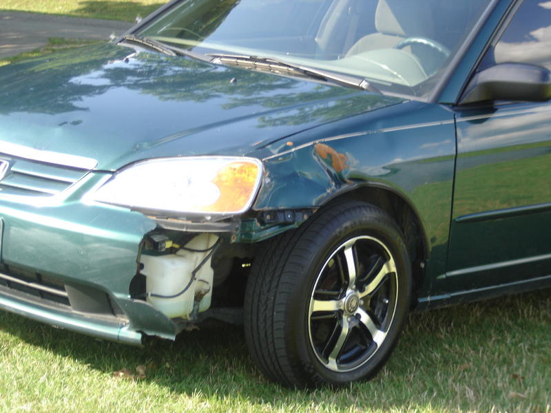

The whole front support. I did an 01-03 to 04-05 conversion. Post a pic of the damage. That steel is pretty flimsy and you can probably massage it back into shape with a hammer and a set of vice grips and then weld a piece of 3/4" strap steel to the back for a little reinforcement.

https://www.civicforums.com/forums/a...7&d=1250116576
Here's a pic with it put together. I'll have to take one later where you can see the underbody.
I did quite a bit of hammering an pulling to get the pocket opened up enough to get the headlight in.
