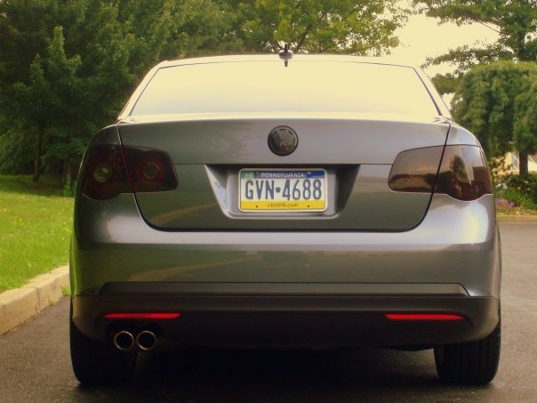

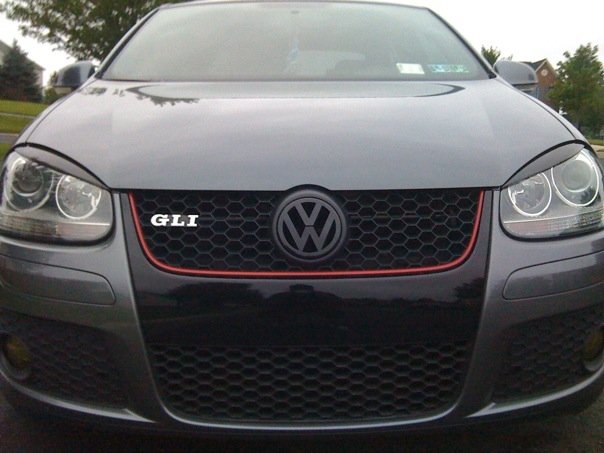

Black Grill and Trunk Emblem
Where could i find a black grill and trunk emblem, like the Honda symbol is black. And do you think it would look good on a 2002 Black Honda Civic LX.
Here's an example of what im looking for:

just paint the oem emblem. i tried it with smoke color metalcast paint which sprays right onto chrome and keeps the shine. i already sold this one but its easy to diy. just keep adding layers til it reaches the right darkness.

i was thinking i sad it down, prim it, then paint it flat black.
think thatd work?
Old Jul 28, 2009
Re: Black Grill and Trunk Emblem
flat? um no that wont look good

Your probably going to want a semi gloss or high gloss so it matches the shine of the rest of your car. Over time the gloss of spray paint will fade so make sure you detail it up after you let it fully dry a week to lock down the paint job. I spray paint a lot (an old hobby... yahmean) and you'll notice that the paint with the gloss built into it wont come out of the can perfectly even. After it dries, you'll get spots that are really shinny, and others that are fairly dull, but with an emblem thats so small you'll hardly notice. If you do, just shoot it with a clear coat/ desired gloss when your finished with the color coats.
I'd either sand it first (which is really hard on the stock chrome) or use an etching primer- which basically clings right onto the surface without the need to excessively sand it down.
