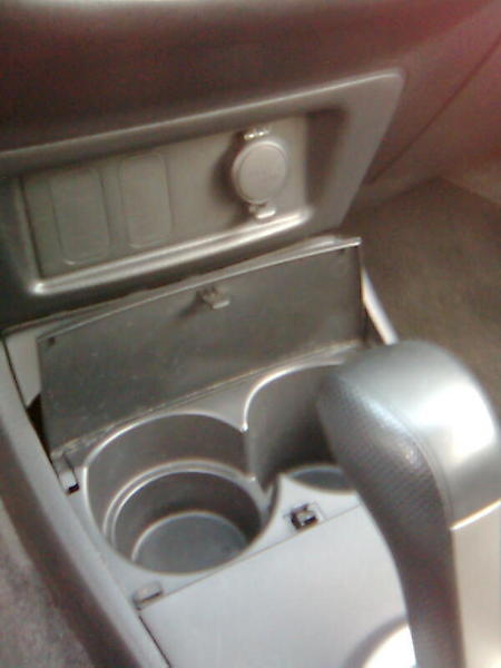

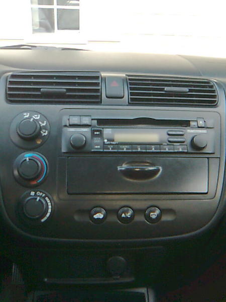

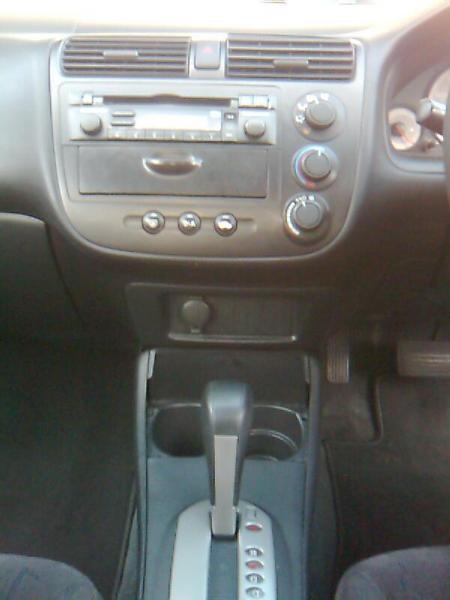

Ok ill see how far i can get but just so you know what i mean i posted some pictures of the interior.thanks

ok well i tries and i just couldnt manage to do it .I think maybe you have to pull it out by the cigeratte lighter part.(dont know what its called).I just want to get this over with because i bought a brand in dash deck.thanks

What part are you having trouble with? You do have to pull the cigarette lighter trim piece out as there are 2 screws underneath you have to remove before you can pop the part of the dash out that houses the deck.

Other than that, I'm all out of resources! Don't forget, you can't pull out the trim piece with the cigarette lighter in it if your cupholders are open! I found out the hard way and almost broke the cup holder lid.

im not totally sure, ive never tried on an automatic, but i have an 02 standard and its pretty easy. maybe you can try this, hope it helps.
put your finger in the cigarette adapter and pull the area out i have circled with green and unclip it from the harness. then pull out the trim area i have circled in red. once you have that done, where i have the yellow arrow there is a screw that you need to unscrew (there might be two but i think i remember one...). once you have that done just wiggle it around a bit and you should see the whole area holding all your head unit, storage, climate control, etc etc start to move and you should be able to just pull forward and it will come out. just undo the harnesses that clip in to remove it.

Thanks man it worked exactly as you said.I installed it just a few minutes ago.Thanks for your help everyone!
