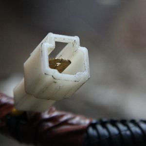

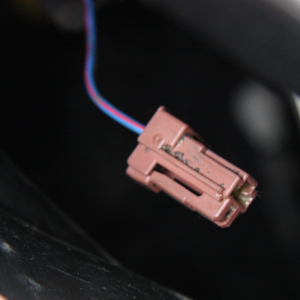

I just recently got the fog light kit (ebay) and got the lights in within a few minutes. But, when I started to do the electrical, I found a little problem.
At the start of the wiring process, it says to open up the right fender and attach the foglight harness to the wire (of the car) which had the blue tape around it. It seems as it these just don't go together. I noticed that a connector from the sub harness can connect to the car's plug but not the actual fog light harness.
I attached pictures of the two connectors.
An ideas guys?
Thanks!

most of those plugs dont even fit right due to quality problems. you may end up having to splice the ones that wont work.
