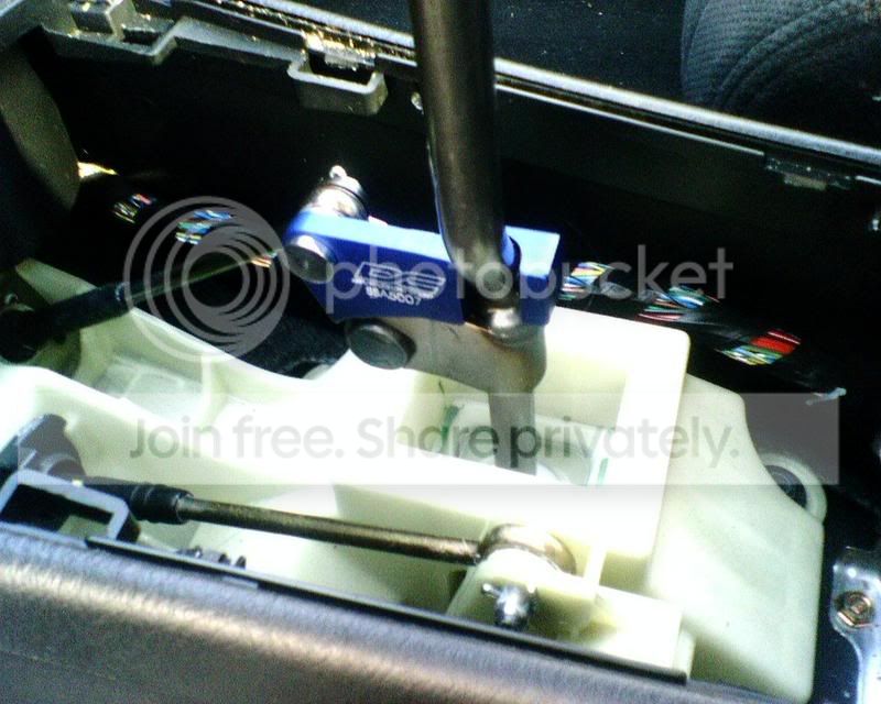

Originally Posted by TWM Website
The CNC machined, billet aluminum shift adapter for the 2001-2005 Civic bolts rigidly to your shifter to reposition the shift cable and reduce the throw by 37%. Four billet aluminum bushings provide a much more solid contact point between the shift assembly and the floor pan removing all of the flex or play in the stock shifter.
If your looking for a "shorter" shifter the Revo and B&M will be the way to go.
The TWM and DC adaptor kit re-positions the actual stock shifter for less throw time. I think the bushings just adds to the rigidity of the shift being thrown. Hopes this helps.

I went with the DC shift adaptor. Was really easy to instal just make sure the allen bolt is threaded all the way through. The allen bolt was the only snag I found but once I figured that part out it was pretty easy. Took about 15 minutes for the whole install. The throw is nice and solid.
