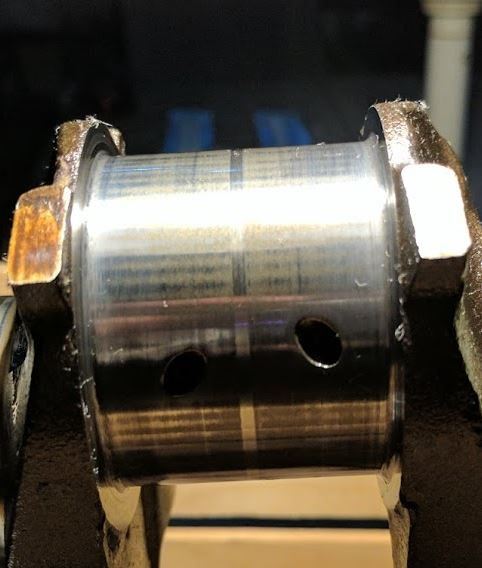

i use engine flush right before i disassemble engines for rebuilding or refreshing. i tend to notice this pattern on the crank journals on engines i do this to. IDK what it is, why the flush seems to make this appear, or how long normal use takes to make it disappear, but it polishes off with 2500 grit and a shoelace with jewelers rouge. i've quit doing periodic flushes since i've started seeing this. i have only had one guy identifty the pattern, he said he has seen it it in neglected engines where the oil was not regularly changed and suspected that maybe the cleaner acts in the same way as old oil that has absorbed gasoline in it.

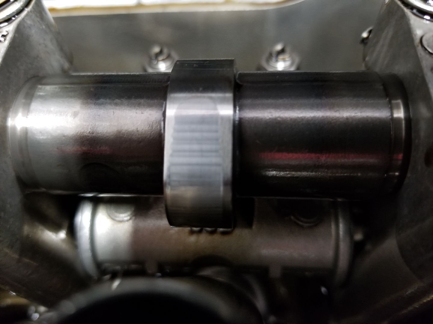

We've seen this chatter pattern on the cam lobes in an engine that had its oil badly diluted with gasoline.
Came in for noise. Cylinder head (complete with camshafts and rockertrain) was replaced.
Finally found pics of it
Very low mileage, something like less than 30k on it. 10th gen 1.5T
