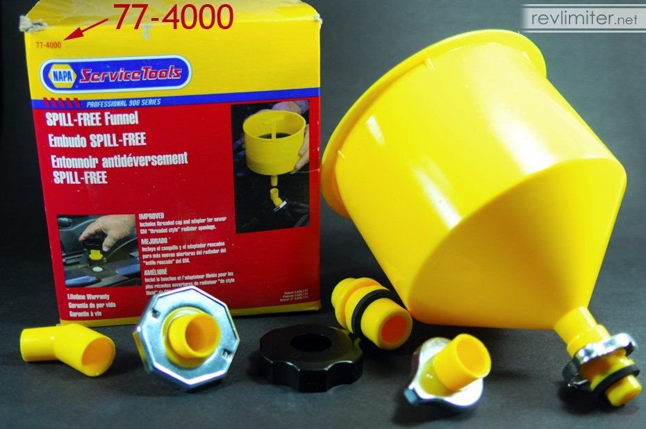

The R engines have no bleeder valve.
I install a spill free radiator funnel (greatest thing since sliced bread, see pic below) and just keep it filled part way throughout the burp process, then brick the gas pedal so the engine stays revved up (actually I use a real throttle jack and set RPM around 3000) and walk away until I hear the fans run.
The higher RPM (and increased water pump speed) circulates liquid through the system with more pressure, which kinda pushes more trapped air out than if you only idle the engine.
I know it still doesn't always get all the air out on the first go around, but I work in a shop--ain't nobody got time fo dat.......So I intentionally overfill the reservoir in hopes that within a couple days it stabilizes within the acceptable range marks.
