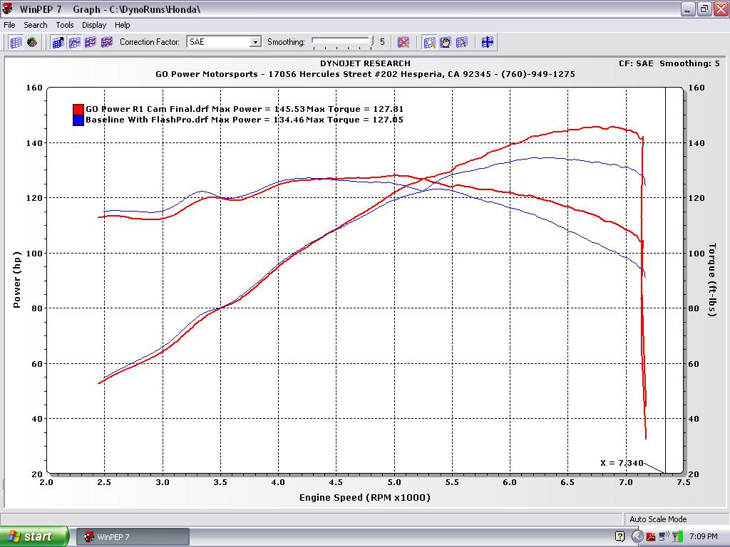

Might wanna look into an aftermarket camshaft, too. Found a dyno sheet for a cam by Go Power Motorsports (apparently bought out by Skunk2) that made 11whp after bolting it on.
Not sure how easy it is to install, but on my D17, it wasn't too bad. Hardest part is fitting the rocker assemblied back on without getting the valve adjustment screws caught on something. No other valve train upgrades needed, apparently.
$449 shipped on thmotorsports
If the skunk2 cam is indeed the same, here's the dyno sheet for it. Baseline dyno has an Injen CAI, Megan header, GReddy TiC catback, NKG plugs, and a FlashPro.
