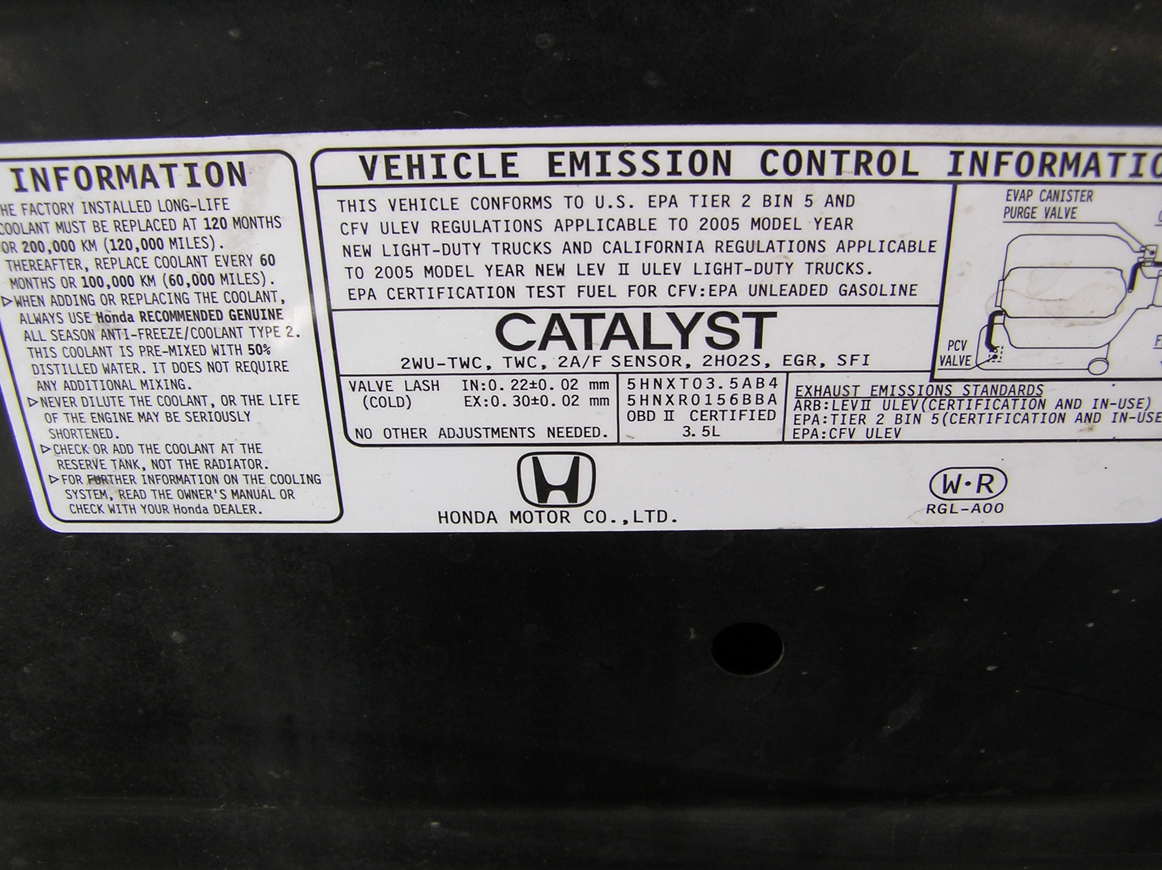

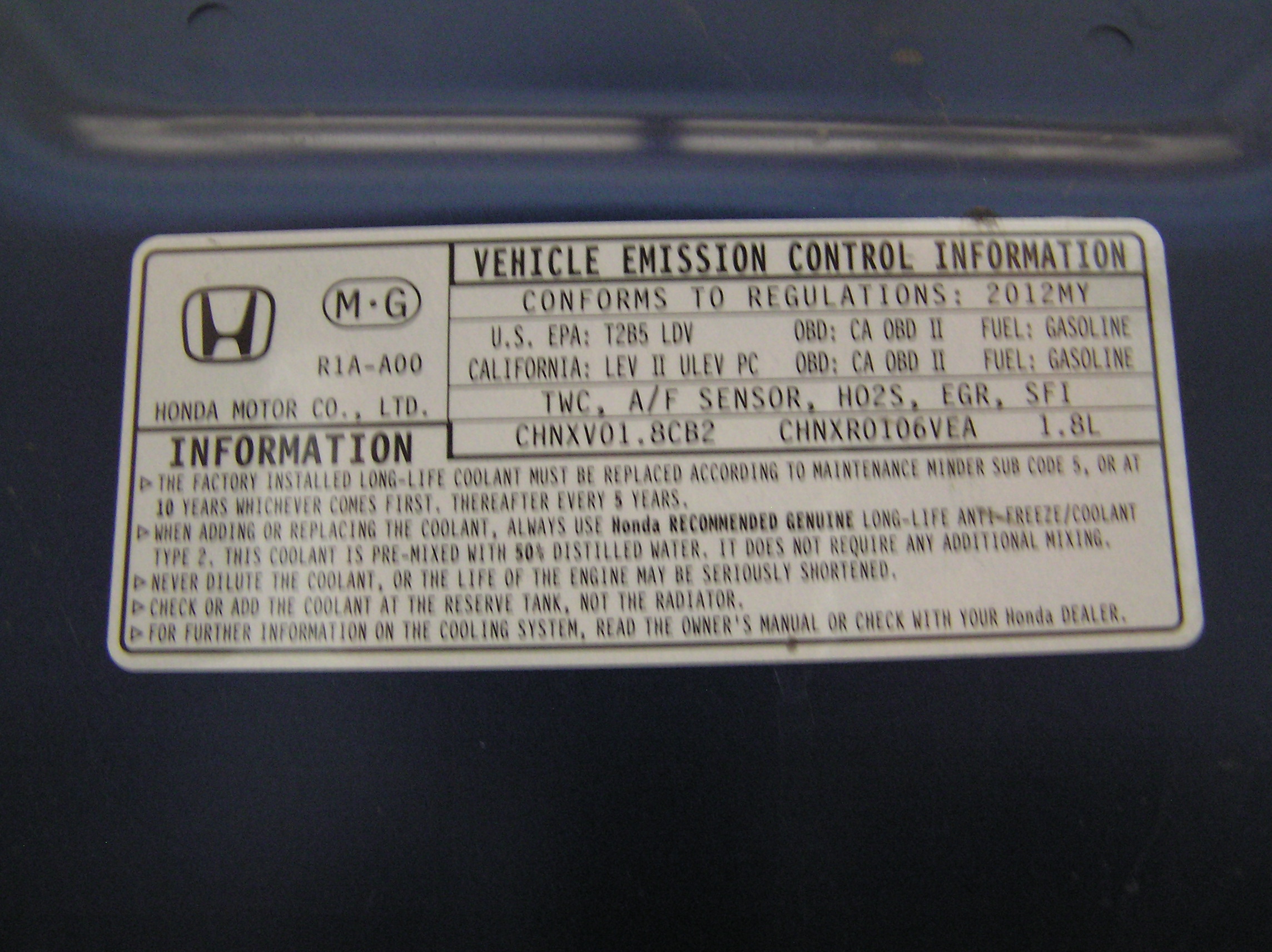

In addition, the underhood label on maintenance minder cars states the original coolant is to be changed at 10 years or minder item #5, then every 5 years thereafter.

It's not about the maintenance minder, that's explained in the owners manual. (Maybe I should have said something like 'on cars equipped with maintenance minder'.)
This is the emissions label.
Pics of the underhood label, this is from an 05 Odyssey that happened to be nearby, (not dialup friendly huge pics):
Not all of these labels are exactly the same, they differ a little bit from year to year.
Here's a label from a 12 Civic
