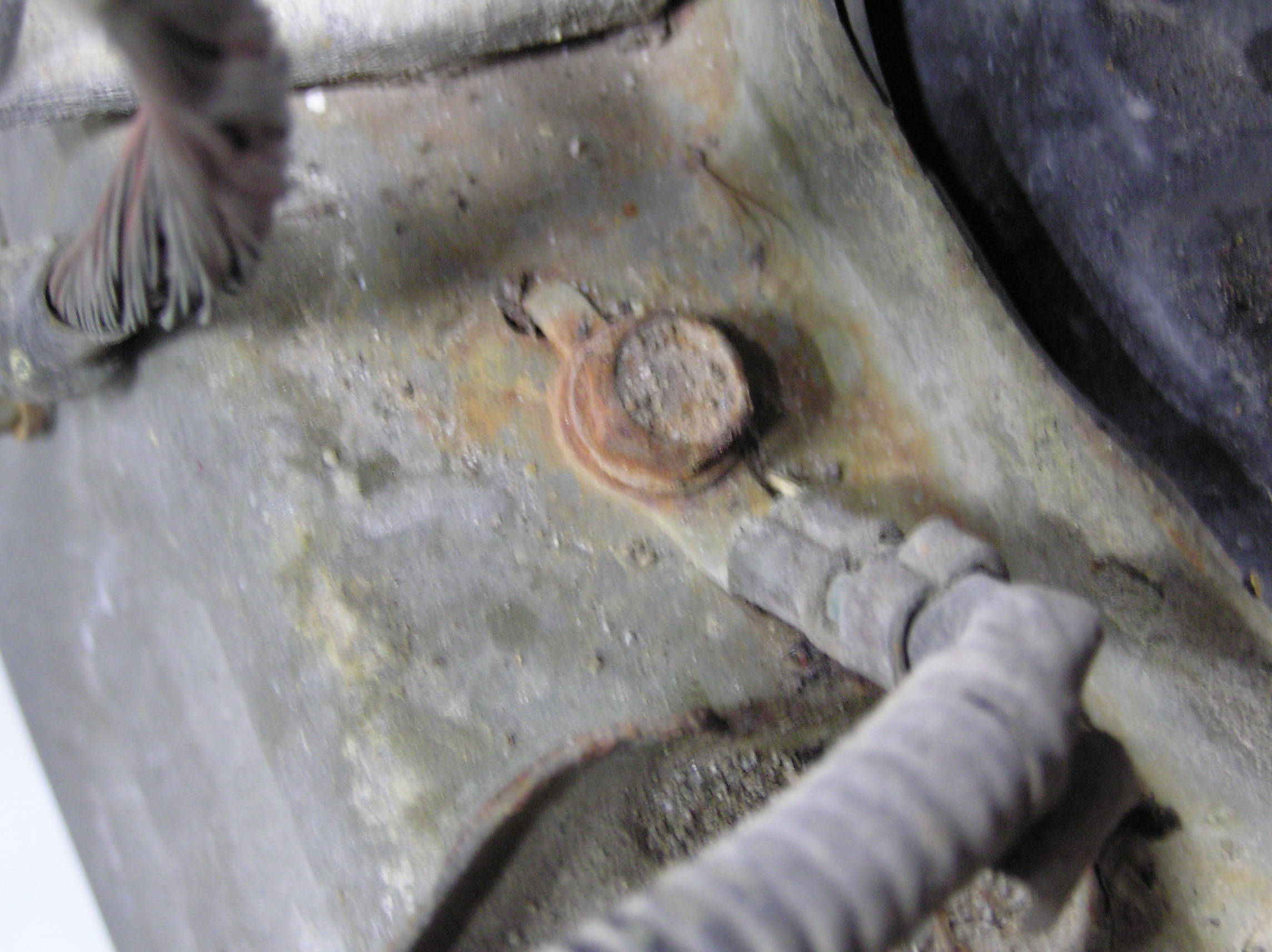

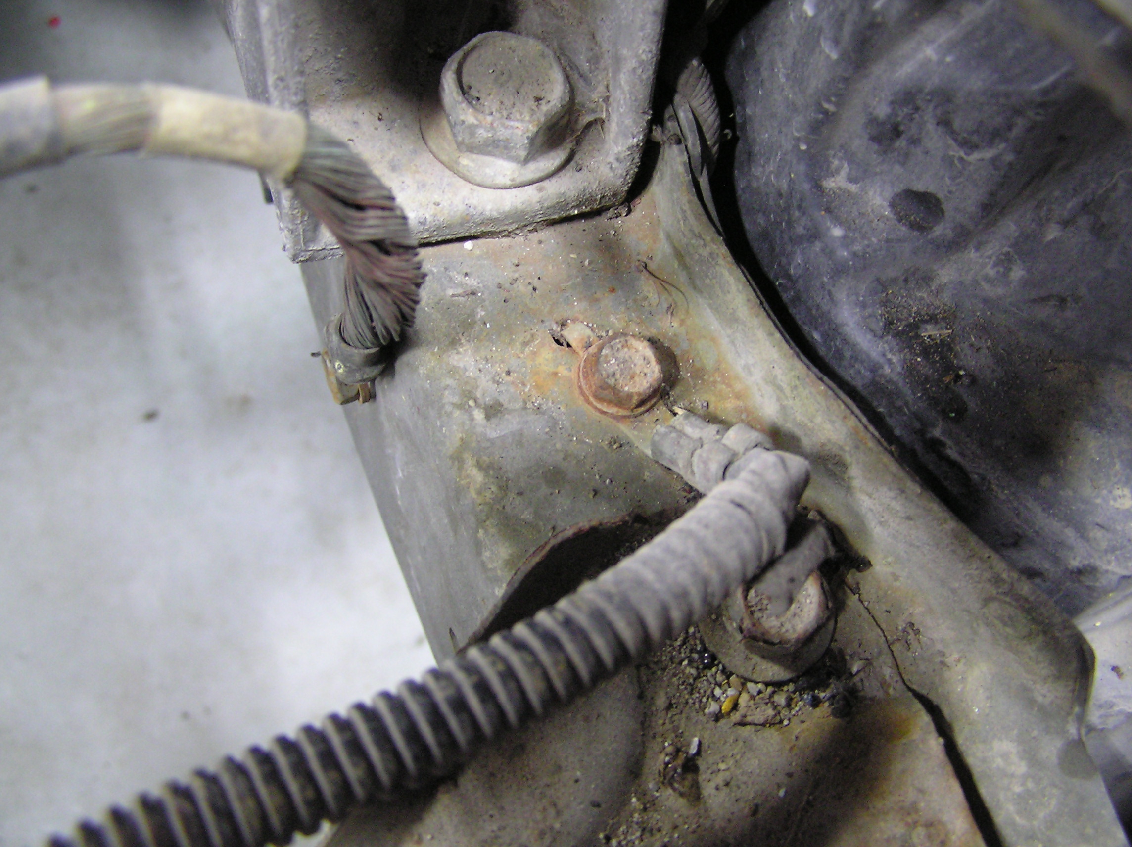

Re: 2007 Civic "cold" start problem
Originally Posted by ezone
Battery cable connections,
Connection where the ground cable attaches to the body: rust and corrosion on the cable and that little bolt has been a common cause of total electric power loss. Ground connections between the body and engine/trans, there is one right near that battery cable.
Here's pics from one I have the engine out of right now.

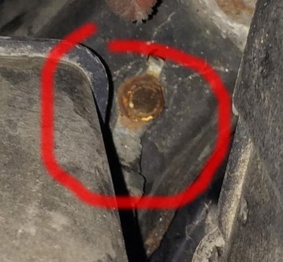

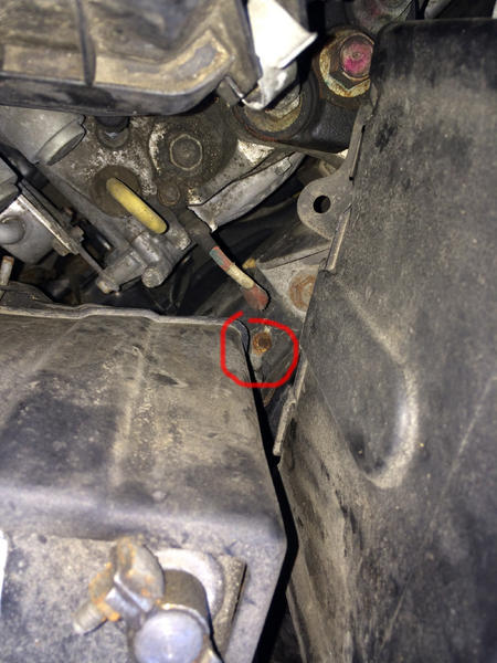

I took a picture under my hood today looking at that same contact point. It looks rusted up like you suggested might be.
The weekend is finally upon us! I will have the opportunity to disconnect the battery overnight to see if the car is draining it like you suggested. What's typically the fix for this kind of rusted contact point? Thanks!
Take it all apart. Pull out the battery if you need more room to work.
Wire brushes and lots of elbow grease. Wire wheel. Maybe a fresh bolt too?
Need clean shiny metal contacting clean shiny metal at every point, whatever it takes to make that happen...... and then I like to slather it all with Silicone Dielectric grease to avoid more corrosion later.
FWIW, right now I have an 06 Civic in here that has a software update available for it, called something like 'cold hard start' as the title, but did not find any documentation about what it is or what it does, or what all cars this might apply to. I cannot say that it could be even remotely related to your issues.
It likely only addresses some starting-running condition rather than any battery related issue.

Well, I tried to just start it this morning and it fired right up. The temperature was 42 F degrees and it had been sitting for 18 hours. So this is a good sign. I'm not going to disconnect the battery tonight. I'm going to just leave it and see if I get the problem again since cleaning up that ground connection. I'm a science guy, so three consecutive days would convince me that it's fixed. I'll keep you updated, but for the moment I am incredibly happy and thank you for your help!

It was 22 F degrees today and it started right up after two turns of the engine! I think it's pretty good for the moment. I'm going to keep track of it for a while, but I really appreciate your help and guidance!

I think the man has nailed yet another.
Congrats on the fix, and thanks for update.
