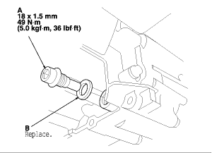

While it's probably been asked before, can someone please tell me where the auto trans drain plug location is on my 06 Civic? Sure would appreciate it, if you are specific. The owners manual states 2.5 qts. should be required, is this accurate? Thanks for your help.

Yes, it is 2.5 US Quarts at the oil change, and 6.2 US Quarts at Over haul.
Hopefully this picture helps you.....
Please make sure to use Honda ATF-Z1 automatic transmission fluid.

Thank you for your help, the picture was especially helpful. Rick
