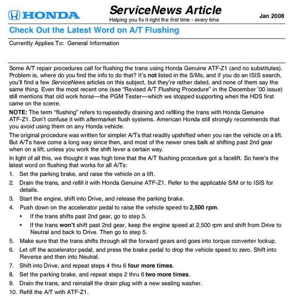

Since you find it strange that none of us have quoted Honda, here ya go.. Directly from the 2006 service manual, I don't have the 2007 manual but I don't know of any design changes.
Under Severe Conditions - 37500miles / 36 months
Under Normal Conditions - 75000miles / 72 month
You should also be advised that Honda has introduced a new type of ATF fluid for 2011+ models called ATF DW-1, its supposed to be back compatible, but I would stick with Z-1 until its been more widely tested in older models.

Do you really think Amsoil would tell you their product has destroyed transmissions..
If you think thats the problem good luck, I'm glad after years of problems we've finally found the solution to the problem. All our findings and proven results must have been flukes.
The R18 transmission has a serviceable filter located under the battery, every transmission Honda builds has a filter its just sometimes they're in the case and aren't serviceable.
Part number 7.

For the record, I really don't care about Amsoil or who uses it. I have been using it for about 15 years and have not had any problems like others report. The important thing is to change to Amsoil, or any other PAO based oil, early in the life of engine or transmission. PAO based oils tend to clean out the sludge and varnish left behind from dino based oils. That will degrade the Amsoil and possibly plug oil ports or filters. I suppose that's what happened to the torque converter in the link below.
I talked to a Service Rep at one dealership and a parts guy at another. Both stated there is no tranny filter, and when changing oil, they only drain and replace the 2 qts in the pan. When I mentioned that leaves 4 qts old oil in the tranny, both just said that's the way they do it. When the parts guy pulled up the same parts break down diagram as posted below, I pointed right to the filter and he was able to order one. Thanks MindBomber.
How long do those tranny filters last?
I think the other problem is not changing out enough of the old oil, especially for abused and high mile transmissions. The only way to do that is continued oil drains and refills, which I intend to do from now on.
Too Tall is offline

The filter is supposed to last the life of the transmission, which is likely why the dealership people didn't realize it exists. It can be changed though and a new filter does a better job filtering the fluid, so I would definitely change it, especially considering is only $14.
