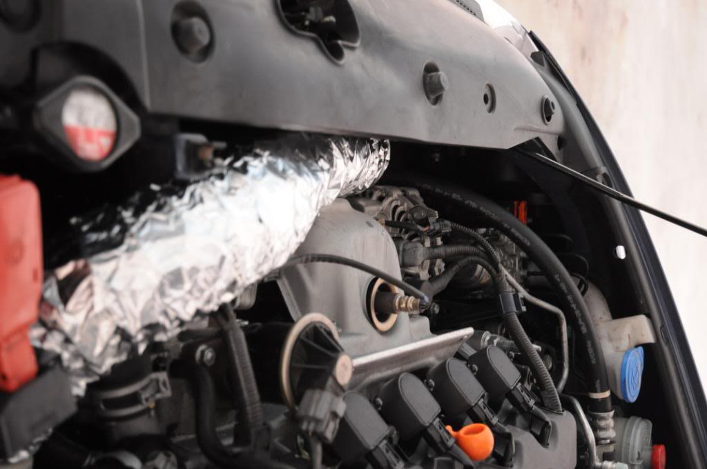

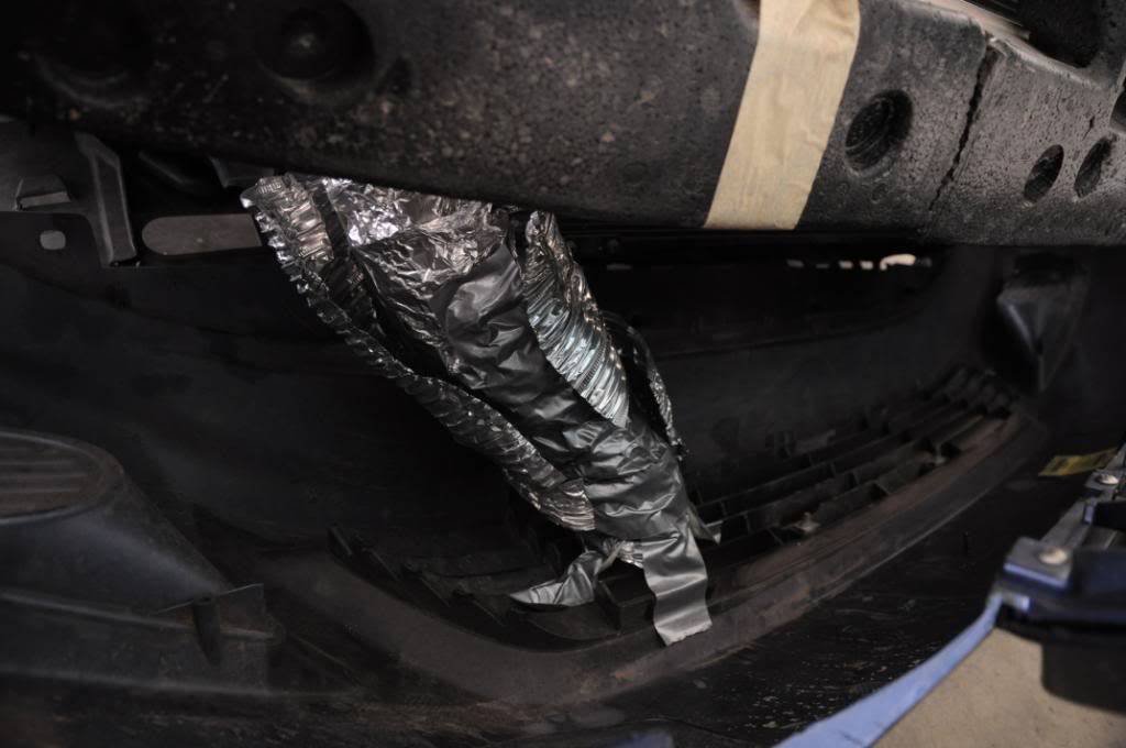

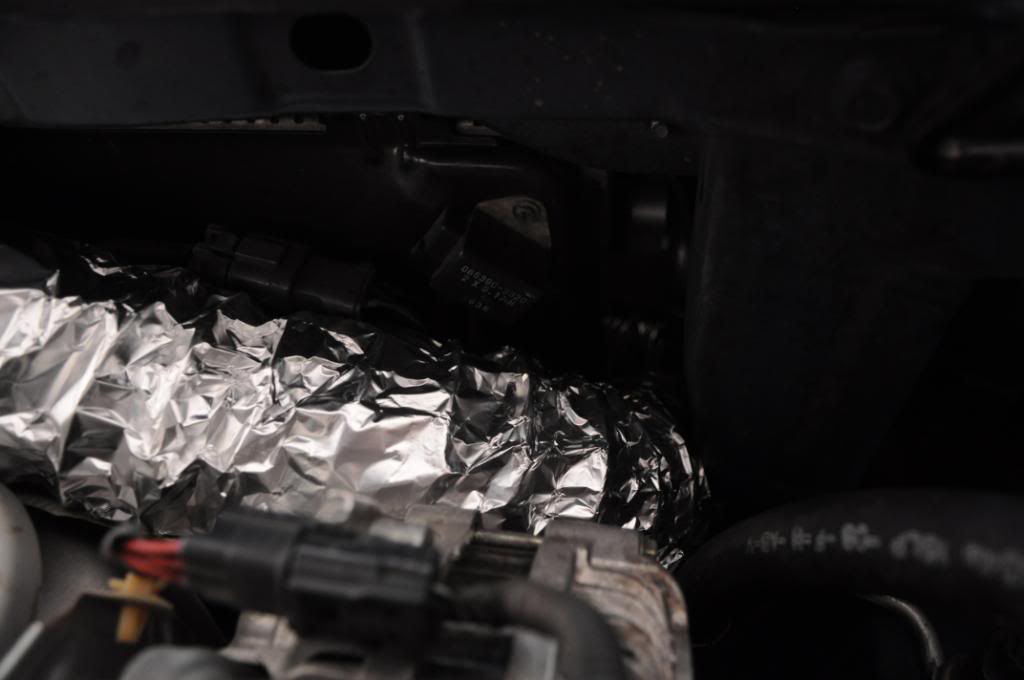

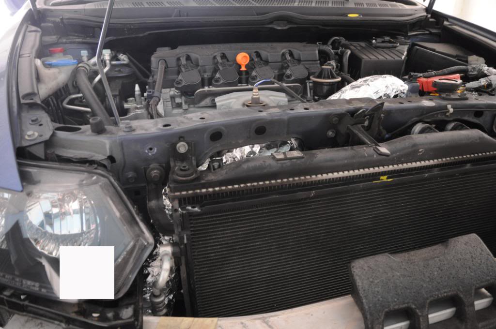

Alright, bought a new duct. This time a steel reinforced plastic 3" duct, called a "bilge blower". I wrapped it with a layer of duct tape, aluminum foil, and then moderately reinforced the aluminum foil with more duct tape. Slid onto the intake port on the air box, ran across the top area above the radiator into an area on the left side of the car. This spot is between the radiator, the wall of the car, and a 1" pipe connected to the radiator. From there ran the duct behind the front grill, in front of the radiator and duct taped it onto the grill fins. The duct was secured to the airbox with what else but...duct tape and string. Hey, I'm poor, I can't afford anything fancy
The results? Besides the HP not dropping off due to engine heat over time since its drawing air directly from the outside, I can also feel some boost in acceleration from 30 Mph upwards. I would say 5 Hp at 30 mph, 7 Hp at 60, and 8 at 90. Not as much as I was expecting, but really thinking about it this is the result that the physics of the system would result in.
When I gas the pedal at a stop you can really feel the air getting sucked in, and the entire duct shakes a little due to the pressure change. Lets you know that you have a good seal.

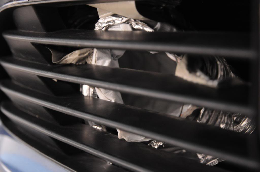

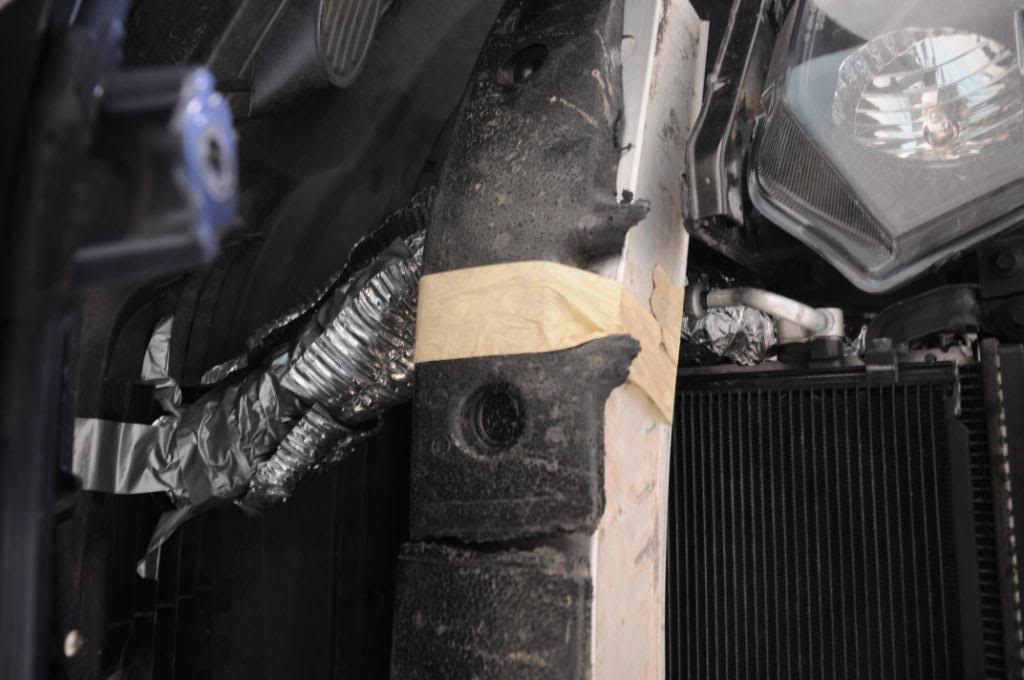

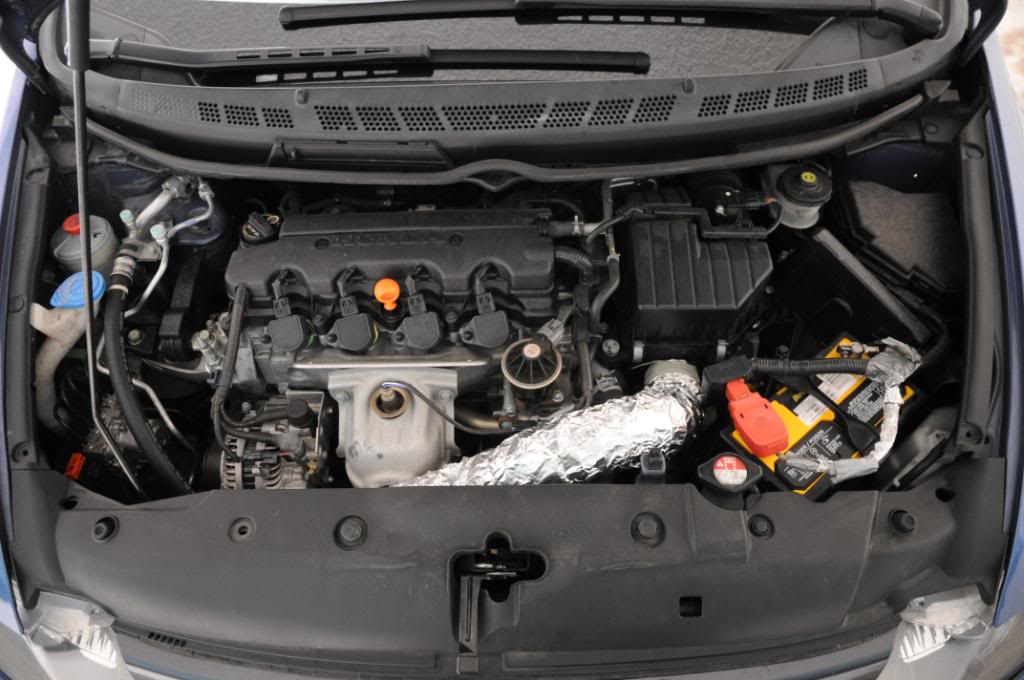

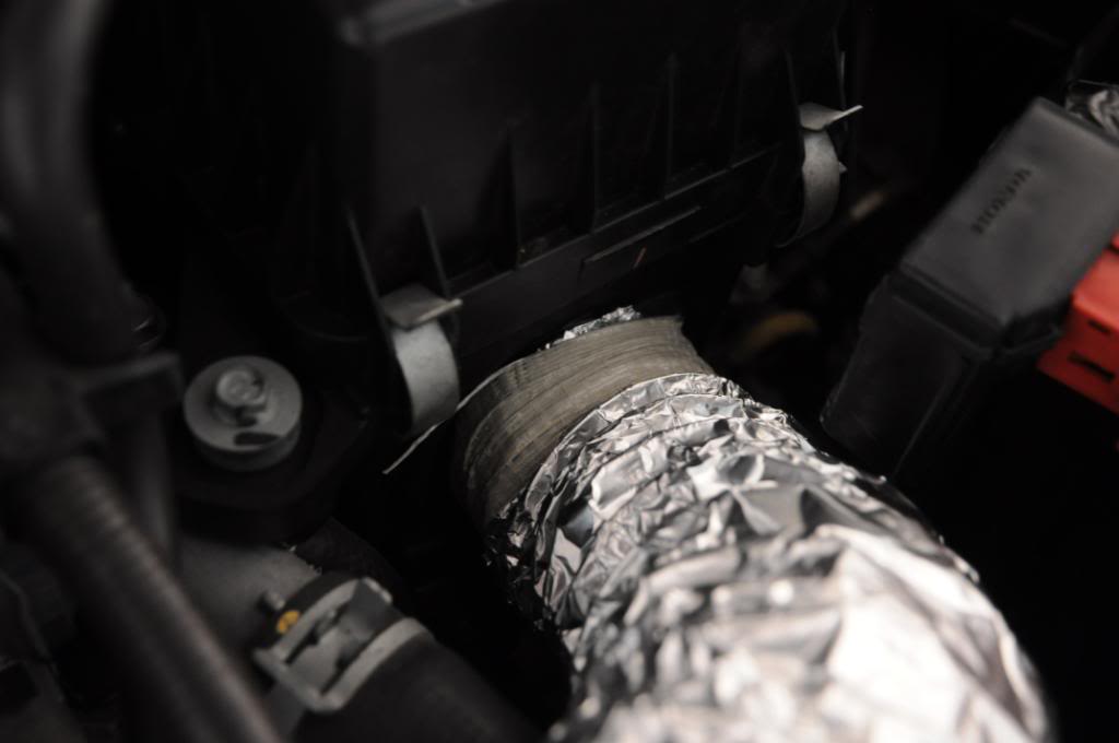

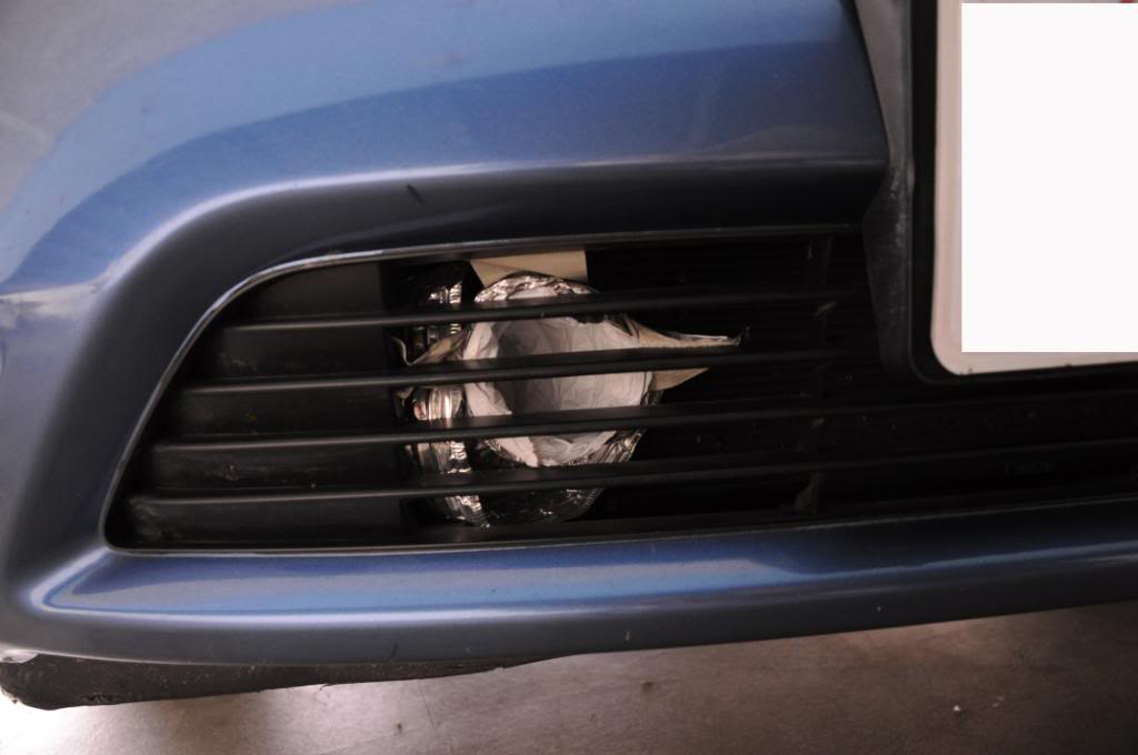

I also put another addition in after taking the pictures. Apparently if you attach a basic PVC pipe to the end of the conduit (in this case, a 90 degree bend), the horse power goes up another 30-40%. The weird thing is that with such a thing installed, I cannot feel the air going into the conduit like I used to while on idle. It must really smooth the air out, hence the HP increase. I am happy with it : )

it doesnt look pretty, but i guess it gets the job done. i wouldve gone with custom piping from intake companies, but its prolly alot more than what you want to spend.

Yea, but at least the portion in the engine bay looks ok. The pipe I put on makes the grill portion look MUCH better though. Allows me to hide more of it, and create a nice flush fit with the grill. For $20 total worth of parts, I think its a good deal.
Btw, you will need to remove some random plastic shroud in that area next to the radiator in order to run anything through there.

Even after you put that pvc pipe on there it probably didnt do anything. You have probably gained like 3 whp and like 4 whp at the most thru the hole powerband. Intakes do not do very much especially on a stock civic.

............weird....should've just removed the air box resivoir and put a cone there...and remove the filter from the box...thats a free cold air intake...instead of pimping your intake....looks like a dryer machine..
