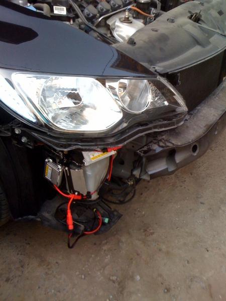

Guys I have a brand new 8th gen civic. I recently bought 3 separate HID kits for the fog lights, low beam & high beam. All have slim ballasts and are rated at 55W. Color temperature is 10000K. I have attached pics for reference. I am facing a problem though.

The installation guy showed me that previously ballasts were overheating as they were joined together. This time they were installed with a distance between them as shown in the pics
Got replaced the faulty ballasts (right low beam and left fog light). The HIDs are in warranty for a year therefore ballasts get replaced during this period.
