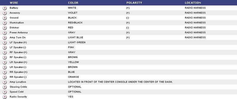

Audio
https://www.civicforums.com/forums/a...3&d=1209819290

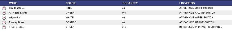

Convenience
https://www.civicforums.com/forums/a...4&d=1209819290

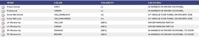

Locks and Windows

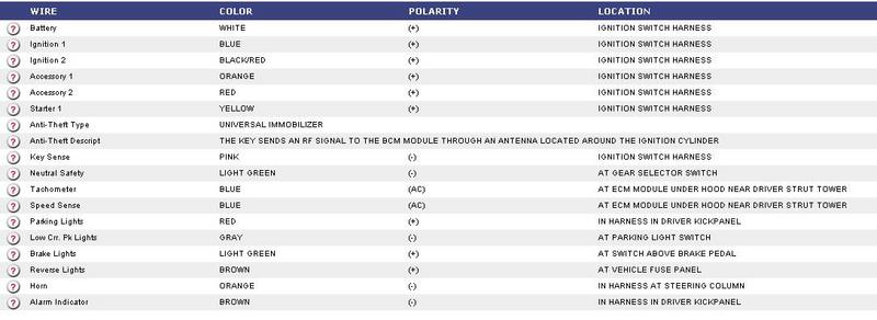

Remote start
https://www.civicforums.com/forums/a...6&d=1209819290

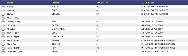

Security
https://www.civicforums.com/forums/a...7&d=1209819290
