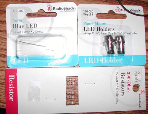

Just bought some LED's & other stuff... Wondering if i got the right stuff.... Please help me out by letting me know if these will work for my DIY Blue Dash...
Ok, I got 4
5mm Blue LED 3.7volt - 20mA - 2600mcd
LED Holder
Accept T1 3/4", 5mm LEDs - Fit 21.64"(8.2mm) holes
5 Resistors
390-Ohm - 1/2 watt - 5% tolerance
I got these items at radio shack... I asked a guy at the counter and he recomended these, i wasnt sure if i needed led holders... but i got em just in case
Are these the right stuff?

Heres a pic of each item

i dont think you will need LED holders.
And i never have seen anyone doing it they way you are..
Take your time to look if you can do it with those resistors, and i hope you know how to solder..

are those the right resistors for the power coming in to the lights?

alright i've done it this way, you don't need LED holders. the only thing different is that i used 670 ohm resistors and they work just fine. The ones you got might work but it may still be too much voltage because the voltage thats coming through is 14 volts. I have all the pictures from when i did this to make a DIY but haven't gotten around to it. I promise i'll put it together tomorrow and put it up.

u cant take out the yellowish led and replace it with the blue led if u did that the blue led would explode because theres 14volts going through the light thats why u need to use a resistor to bring the voltage down to about 5volts
The led would not blow up it would burn out really fast. and what is in there right now are bulbs, not leds. you are right about the resistors though
