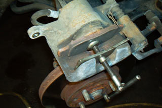

you will also need
white lithium grease, a 17mm socket, and a 12mm socket
using the 17mm socket, take off the bolts holding the entire brake caliper out, using the 12mm take the brake pad holder assembly out
reset the caliper piston like so
