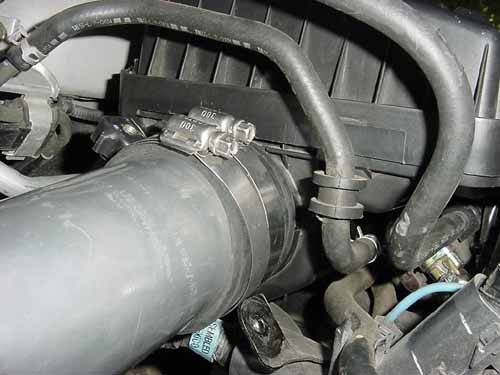

Read the instructions above...then look at the pics!
Name:	airbox with rubber thingy.jpg

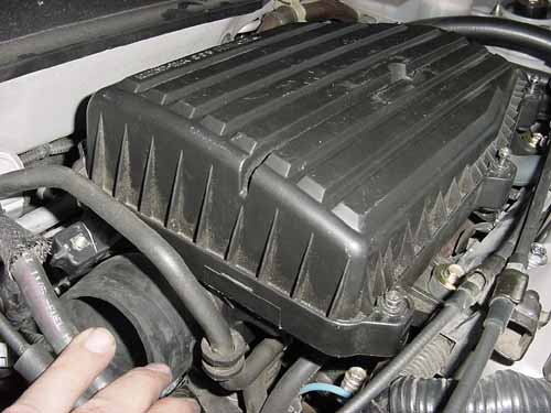

Another shot...
Name:	airbox with rubber thingy 2.jpg

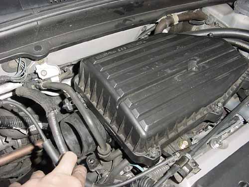

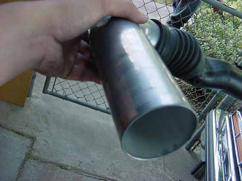

intake with rubber nozzle....
Name:	intake with nozzle thingy.jpg

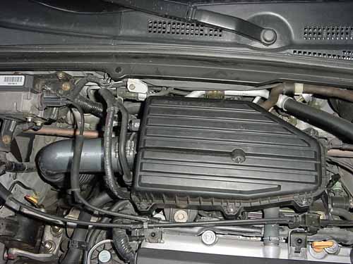

again...
Name:	intake with nozzle thingy 2.jpg

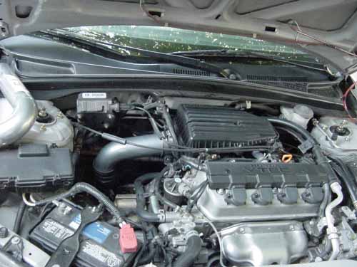

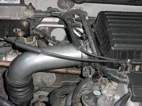

Final results...
Name:	intake in stock airbox 1.jpg

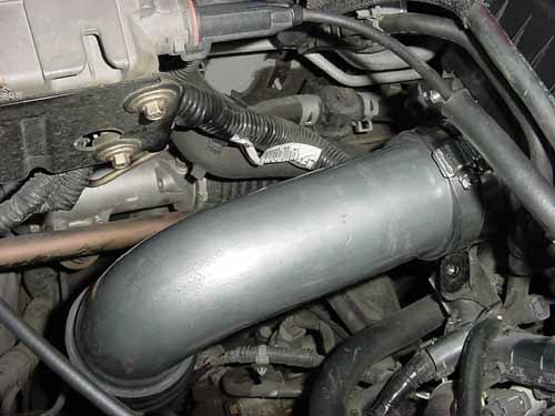

and so on...
Name:	intake in stock airbox 2.jpg

Old Jun 9, 2003
4jacks's Avatar
Posts: 1,389
From: Abingdon, Maryland, US
Rep Power: 309
4jacks is a glorious beacon of light4jacks is a glorious beacon of light4jacks is a glorious beacon of light4jacks is a glorious beacon of light4jacks is a glorious beacon of light4jacks is a glorious beacon of light4jacks is a glorious beacon of light
I don't get it....
What filter are you using the K&N style cone, or the stock.
if your using the stock, isn't the stock hose drawing air from the side better than where your drawing air from ??

the only filter that I have in there is the stock air filter in the stock airbox....there is no K&N filter on the pipe at all...plus, when it was all stock, it was still sucking in hot air....i angled it the furthest i could away from the engine and all the hot components...

This makes no sense, you're now sucking in air from between the exhaust downpipe, the tranny housing, the engine block and the firewall. The firewall is insulated to keep the heat out, and the other 3 are hot as hell... whats the use of this? You just put the induction point in what could be the WORST possible place.
Try this... Leave the air box exactly where it is, and re-route your intake point under the battery. There's a big open area between the bottom of the battery tray, the splashguard and the side of the radiator. Protected and the air will be much cooler than back there. You're not going to accomplish anything by leaving it where it is. Shouldn't be too hard to do... use the wiring harness bolt the Injen CAI uses to fasten the pipe to.
Old Jun 9, 2003
PaCiFiKbAllA's Avatar
Posts: 768
From: Sacramento, California, US
Rep Power: 319
PaCiFiKbAllA has a reputation beyond reputePaCiFiKbAllA has a reputation beyond reputePaCiFiKbAllA has a reputation beyond reputePaCiFiKbAllA has a reputation beyond reputePaCiFiKbAllA has a reputation beyond reputePaCiFiKbAllA has a reputation beyond reputePaCiFiKbAllA has a reputation beyond reputePaCiFiKbAllA has a reputation beyond reputePaCiFiKbAllA has a reputation beyond reputePaCiFiKbAllA has a reputation beyond reputePaCiFiKbAllA has a reputation beyond repute
Like I stated before I did 4 runs and changed the angle of the piping 3 ways and where i have it now is optimal for me. As for the pipe, since the pipe isnt' that long it doesn't even come close to the downpipe, and its not even facing that way...i couldn't get my camera all the way inside to show u guys that...damn mavica's!!
