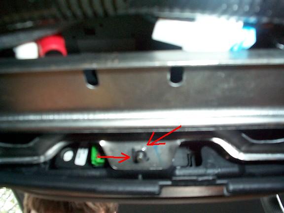

alright, im still having trouble with my. my 2002 civic coupe is being really gay. i took a picture of the only screw in there and it is a frickin square!!?? wtf?? how am i supposed to unscrew that? i posted a picture. please help.

get one of those gator wrench things that can like work with ne size of nut its like 15 dollors.. would that work guys?

nevermind i figured ou the problem. i took the car up to honda and they said that when they installed my CD plyer they took out the bracket with the screws in it to fit the CD player. all i had to do was to pop out the center piece. thanks for the help though.
