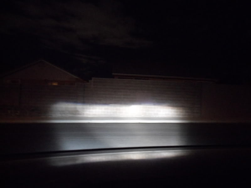

I dunno.. my 6000k HIDs look pretty damn white.. Hell, you can even see small splotches of yellow. Then again, it is an HID retrofit.
As for glare, in this shot (8000k in halogen projectors) there's glare toward the passenger side. It's kinda done on purpose so it actually lights up signs on the side of the road.
I NEVER got flashed with my HIDs (halogen and HID retrofit alike) because I had them aimed properly. The cutoff was aimed at a 2" drop @ 25 feet
edit: Dammit.. I told myself I wasn't gonna get into this conversation.. Oh well..
