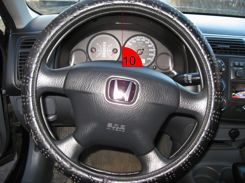

Question Steering wheel always tilted! :S
I've had this "problem" (it's in quotes cause it's not really a problem, but more of an aesthetics issue) for a couple years now and I really only noticed it after I had a flat and had a new tire installed. Anyways, the thing is, when driving straight, my steering wheel is turned slightly to the right; about 10 degrees. It would be equal to a slight turn. I've attached a photo just so you can see what I mean. My car runs fine, but it is rather annoying knowing it's there. :P
Anyone know how I could fix this? Assuming it's something a newbie could do.
Thanks.

Re: Steering wheel always tilted! :S
an alignment.
Toe is out... needs a alignment...
Are your tires wearing on one edge?
I didn't notice any abnormal wear. Then again, I can't see the condition of the tread on the inside of the tire. I've had the tires for many years now and are probably do for a change (except the newer one that was replaced do to the flat) I've watched some videos on Youtube and it seems everyone is right ... my car needs an alignment!
Before you get an alignment try swapping the front wheels from one side to the other. Sometimes when one tire is worn or old on one side of the front of the car car and the other side has a new one, it can make the car seem to be out of alignment. If swapping the tires straightens your steering wheel you know it was due to the tires. If it doesn't work, you know you need an alignment and at least it didn't cost you anything but a small amount of your time.
Thanks.
SO you had a new tire installed...maybe it is smaller or bigger in size than your other tire? This would cause your alrignment to be off...check the numbers written on the sidewall of your tires to be sure they are both the same size. If they arent the same size you can put the rear tires on the front and the front tires on the rear and this will fix the problem.

You both bring up a good point. The new tire right now is at the back passenger side and the steering wheel is crooked but the car drives straight. I had the tires rotated (I believe the back ones move to the front and visa versa) and the steering wheel went straight but my car pulled to one side when driving. So I had the tires put back the way they were.
Now, as for the numbers on the side. I thought I checked this and ruled it out but I thought I'd go out now and double check.
The older tires: 185/70R14 88H
Newer tire: P185/70R14 87S
185 and P185 .... makes a difference?? 88H and 87S??

The 185 and p185 is no difference the "p" is for passager car tire. as for the 87S and the 88H they are speed ratings for the tires you should have the same speed rating on the same axle. you do need a alignmet done on the car so the wheel is straight.
Sarcasm is warranted here. Have you looked at the inner part of the front tires yet?

speed rating simply refers to how fast you can go on the tire before it rips apart. usually lower speed ratings are cheaper and more unsafe. the speed rating set by the manufacturer is higher than what the car could actually go for safety reasons. but using a lower speed rating than recommended is a really bad idea. i think 01-05 civics call for H rated tires but you can go higher.
i forgot to mention, the speed rating only holds true for new tires. once they become worn, punctured (and repaired), or aged, they are no longer safe up to the max speed. the system was basically developed for other countries with high or no speed limits so you get cars routinely going over 100mph. in the usa, i doubt most people would ever drive that fast on a daily basis, except maybe in a police chase. in which case, the tires are so worn already that you will end up destroying them.

So I finally got around to looking for abnormal wear on my tires. They look like they're wearing evenly. There is slightly more wear to the sides of the tread as appose to the middle of the tread, but it doesn't look too bad. (Under-inflation??) I did notice that it looks like the tread is wearing down to those tread markers, whatever they are called that tells you that the tread is bearing it's limit. So as I said earlier, I'm probably going to get the three old tires on my car changed with new ones that I have sometime this year and then have an alignment done.
I believe the new tires I have are of the same make (Michelin) and same speed rating and everything else. I'm pretty sure the tread design is slightly different and have heard not to mix different designs. Why is this? Anyone know?
well, first i said about the tire size being different even for same tire company and same tire size, but if you try to mix different tread design, there is a possibility that they have different rubber compound, which could mess completely the car or on some cases work well (not usually happens when 1 different from 3, maybe for front/rear different). Equation is very complex, cannot say about another tire maker either. going into details are too complicated and not worth it anyway. Even in this situation tires could be different, and the reasons are enugh to fill a book, sorry. Ever wondered why spec race teams have a room full of pistons to choose the pistons that match weight? well, these are metal, tires are rubber...
So bottom line is to get exactly same tire in each axle (left/right matches). if you know enough of cars (first) and enough of tire behaviour matched to your suspension, do taht.
If not, always get new 4 tires. getting just one when others are wore out was not a good choice. if your new one is not too wore out, get the other 3 or just one for that axle.
Almost forgotten: if you still have the steering tilted, swap the right/left tire and see if situation changes. if not, get an aligment. if tilt changes, change the older tire. if still happens, ask to change the new tire - it could be the cause (don't think it happens with michelins, but....)
Thanks.
and after all this, i re-read your post... you steering tilt WORSENED AFTER the tire change, but it WAS ALREADY TILTED... you have had the new tire for about a year now.
just put new tires on all 4, go do a alignment and report back here please. Then if you still have problems, let's talk about if tires do make a difference... first things first, then mental masturbation...
Dish out the extra 100 dollars and buy 4 tires instead of 3. It's always good to have all the same tires.
