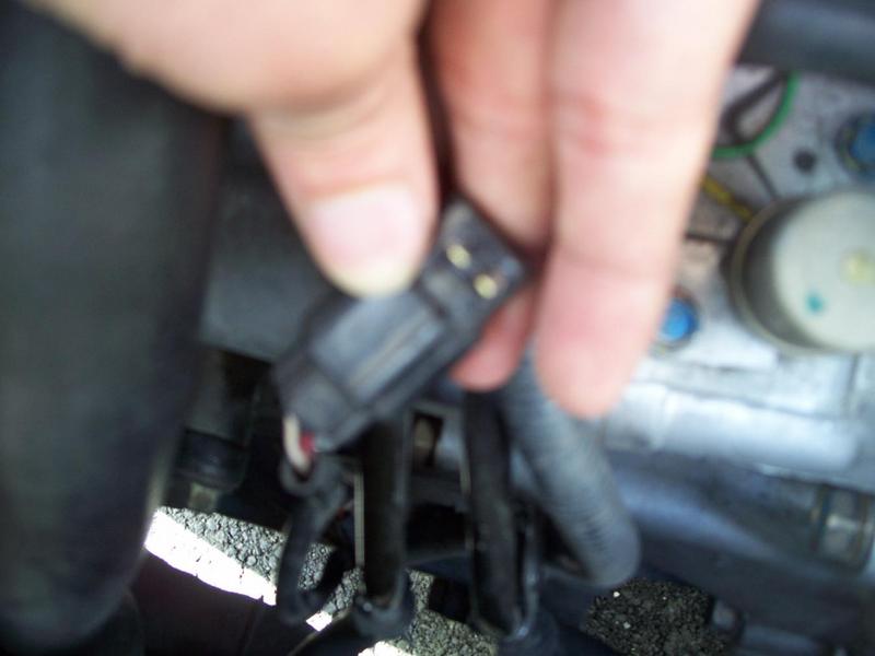

D4 light on my 97 Civic EX Automatic (115k miles on it) starts flashing as soon as I turn on the keys. Also I feel a sudden jerk when changing from N to D4.
I tried to get code for it by jumping the service connector.
The code is 1 long flash followed by 6 small flashes, that means 16. Looking at manual code 16 means Linear Solenoid.

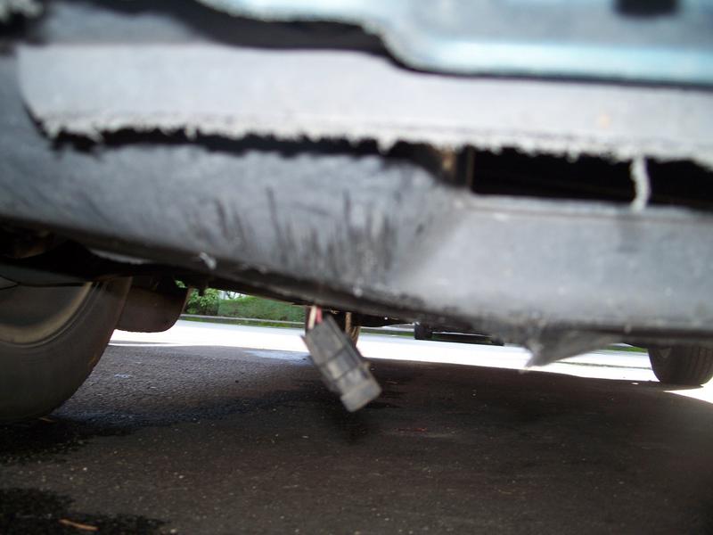

Also I looked under the car (didn't put it on jack) and see some connector dangling in the center .
It looks like a 2 wire connector, Wires are White and Red. Looking at manual it seems like a connector for Linear Solenoid Valve but I am not able to figure out where it is actually on the car,
Attaching the pic of the dangling connector.
Could you please tell if that part in picture is just the connector for Linear solenoid or its completely broken. Can I access it by opening the hood or it can only be accessed from under the car?
I am just thinking will just connecting it again fix the problem?

Take a look at this diagram and look at 5
http://www.hondaautomotiveparts.com/...ISSION+HOUSING
