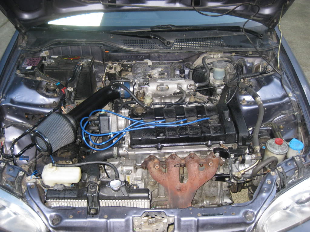

finished my B18a1 swap on my 94 civic 4dr and it runs and drives great, i got 400km on it now. It was complete plug and play. i had to fab a front crossmember that bolts to the tow hook spots for the front motor mount. i did the swap for a total of $400. bought a rolled 91 acura for $200 then did the water pump timing belt and a new cv (blew one up coming off the line hard) OOPS!! im running my odb1 injector, 16v obd1 dizzy, all my 16v sensors and ecu. im sure its running to lean but i got my shift light set at 3500 rpm, i do ignore it sometimes tho... also redid the trunk
let me know what you all think

Nice setup.. especially for that money! Have any pictures of under the hood?
